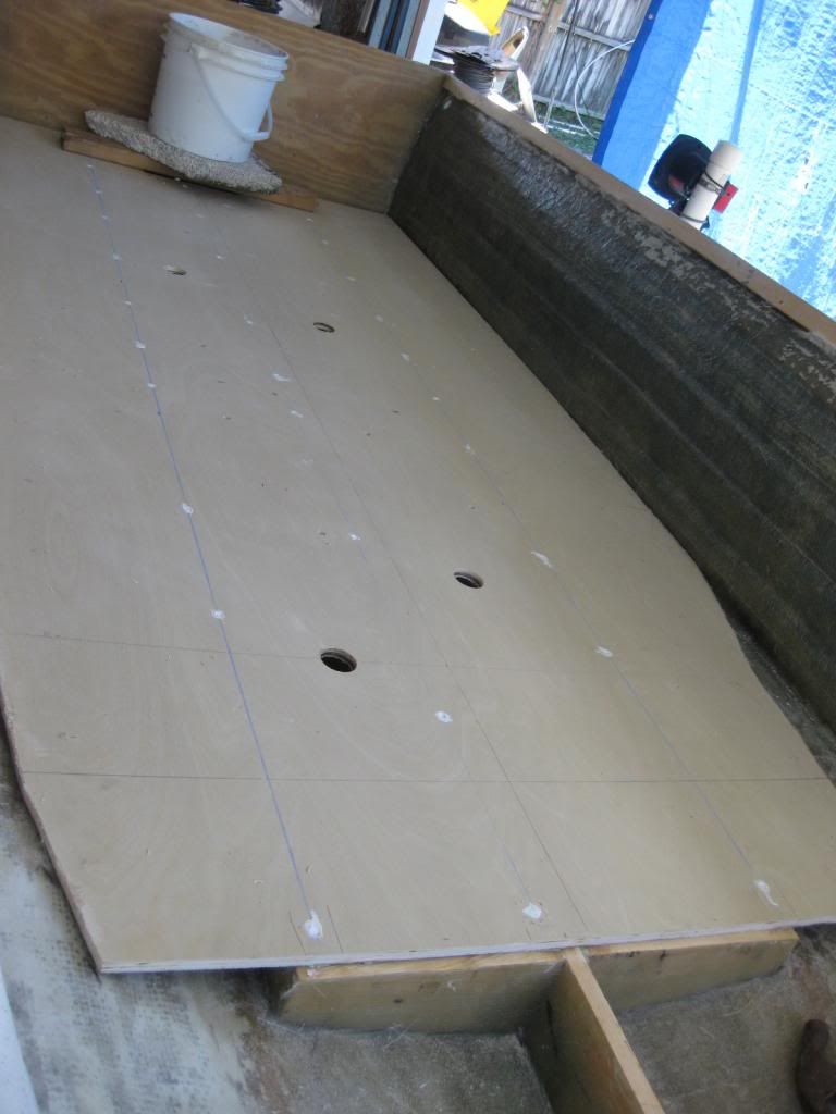

How do you keep the deck from pushing up when the foam goes in . I know the boat does not have stringers but could ya add some to give the deck something to fasten to ? Just wondering ..

This was my main piece of decking going in. Toward the transom, it hovered just above the hull.friderday i'm planing on a keel stringer and foam spacers around the edge to tighten it up .. Thing's are fixing to slow up a little on this restore. I just purchased a used 20 hp Merc and a older Motor Guide bow mount trolling motor this morning .lol...nice one Sam!!! Braces look good..I know it'll be a pain to work around them, but at least you know hull will stay put.& you can put the cap back on as soon as transom done. Sam brings up a good point...I think the reason I am so drawn to this boat is that it reminds me of mine. Looking at your partial deck removal only confirms similarities to mine. Albeit, mine had stringers, but besides the center one, the other 2 were no more than a 1" x 3" on its flat side. The "deck" didn't even go all the way over to the gunwhales (sides) of the boat. I made stringers just high enough to raise my deck so it would just about almost rest on the hull out at the edges, just so I had a full side to side deck & not just one 18" off center. By the looks of it, without stringers, yours seems to rest just about in the same spot mine does now. You could either put some foam spacers around the edge to steady it where you want it, then tab it in with a couple layers of 1708. Although I would have to agree with jig, in that at the least I would put a keel stringer of some sort...it won't be very tall based on your current deck height, then add the tabbing. That along with some pourable foam, again won't need much, & I think your new deck will be well supported. Maybe do an xtra layer of glass on the under side too.This was my main piece of decking going in. Toward the transom, it hovered just above the hull.
Woodononglass, thanks for info before i made a mistake. As for specs I'm wondering if I can make some topside changes to the seating. The original seats and pedestals were glassed into the deck( I'll post a pic) . I was thinking about going back with a bench on the stern side and a single seat on the front .THS your low deck hull was specifically designed and engineered to be a '"No Stringer" foam filled and supported Hull. You can add a keel if you want but IMHO and the opinions of the original designers it's not needed. Once you replace the deck and tab it securely to the sides of the hull and then pour in the foam so it can fill the cavity below your hull will be more than capable of handling the loads it was intended and designed for. Them naval engineers and designers are right smart fellers and they don't like getting their pants sued off when things fail. That boat lasted a lot of years with it's original design and will last a lot more if you put her back exactly the way she was. But, like I always say, It's your boat and you're free to with it as you see fit. Just stating what my experience and research has taught me. Everyone else's opinions and methods all have merit as well.![]()
