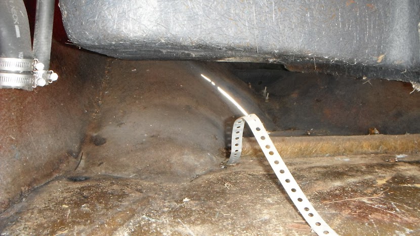

More.
Dont know what this thing is, has wires coming from it.
What ever that plank of wood in the center is call, it will need to be replaced. A good amount of water came out from under it when I cleared clogging debris.
