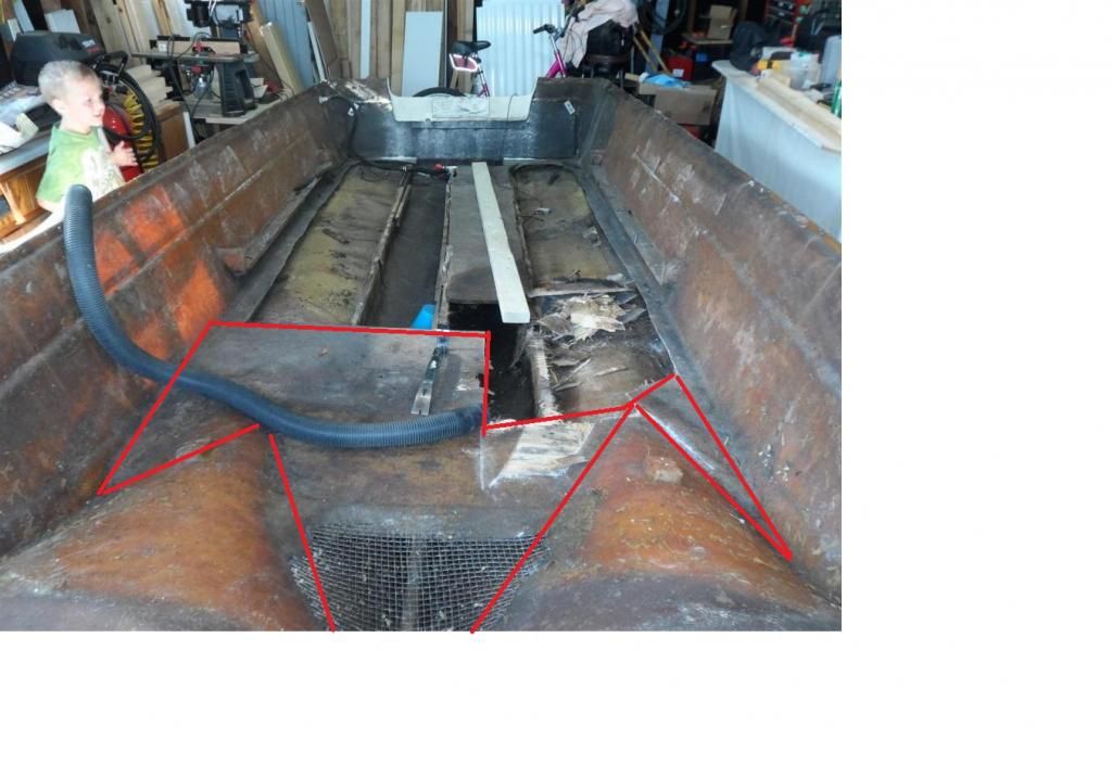

Screen Drain: There is a metal screen glassed in up front, it is just in front of the foot area/walk way part of the cap. I am guessing it is part of a "drain" system. It leads to the area on either side of the main stringer, which should be filled with foam from what I have gathered on this site. Even if water got in under the seats, it should run to the back and not necessarily to this screen. I have not seen another trihull with this type of setup. Any thoughts? Should I keep it, or cut it out and extend my wood and glass up there? I was planning on this just having the normal bilgewell/deck drain system that I have seen on most trihulls.

Anyone have any thoughts on if the drain was original? Should I keep it with the center drain down the boat? or cover it over and fill all 4 cavities with foam? I'm really not sure how much good the drain would do. The molded seats are about even with the drain so that water will flow back to the floor anyway.

drain screen (this is the only foam that was under the cap when we lifted it off)
close up of screen
after the foam has been removed

I think I am going to cut the screen out, I can't tell if it was original or not (it looks like a few different ages of fiberglass in all of this), and just run plywood up where the screen is and then fill the center 2 voids with flotation foam. If anyone has ever seen anything like this, or thinks I should keep it the way it is I would appreciate your thoughts.

About the screen...
not real sure why anyone would want to expose the stringers to any possible water intrusion. I would want everything encapsulated and keep the water away from the wood period, but that's just me.
Pretty sure that the foam you pulled wouldn't be enough to keep 'er afloat if you breached the hull either.

Finally had a few hours to get at it with the grinder and oscillating tool and was able to get most of the front junk out.
as soon as it get the small cross brace out I will be able to mock up my templates for my stringers. I used my oscillating tool to get through the fiberglass and the grinder some around the edges. The wood was rotten and flimsy enough that I was able to pry and pull it out. Very little cutting needed.
If you can tell from the pictures, do you think my flapper sanding wheel will be enough to smooth this out or should I stay at it with a regular cutting wheel? I have not pulled the flapper out yet.
