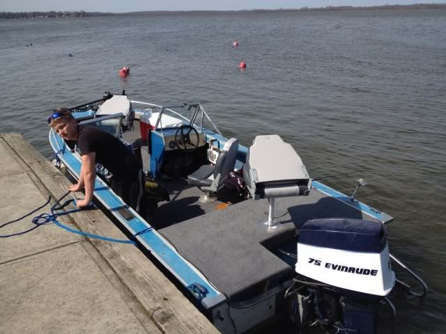

SPLASH!!!!!!!!!!!!!!
Didn't get everything finished, but splashed anyway. It was windy and a tad choppy, but we had a good time.
Took on quite a bit of water....I never replaced the bolts that go thru the transom and connect with the knee brace. I could see right thru the holes. :facepalm: I ended up stuffing duct tape in the holes with a screwdriver to stop the leaking. The Rule 1100 bilge pump worked like a charm. :)

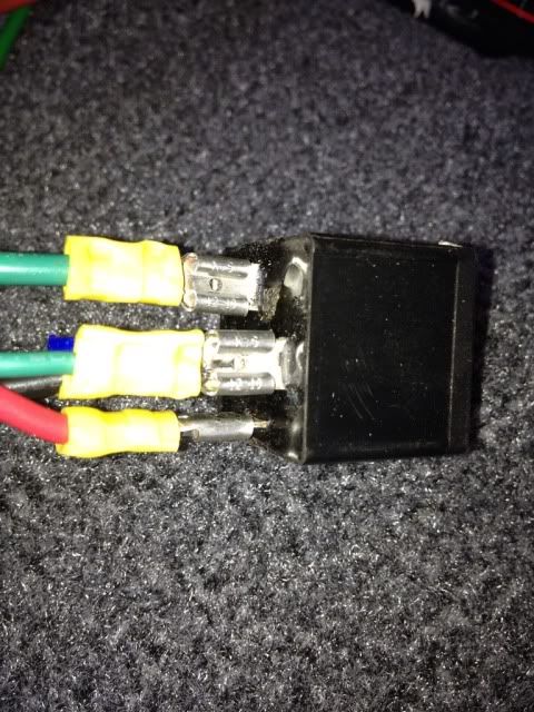

I ended up pulling the TNT relay wires from the holder and put new spade connectors on them. The TNT worked flawlessly while on the water

Did you forget the plug? Nah, I left 3/8" holes on my transom. :facepalm: The pump worked. :D And nothing serious happened. Note to me - Get some new duct tape, you never know when you need it.
Nice fish, so another successful splash. :cheer2: Good on the TNT working after the wiring change.
Have a lot of great trips. :rockon:

We had been fishing for a bit...when I decided to check the bilge. The bilge was full and water was coming onto floor. The Rule pump made pretty quick work of all the water though.
We were fishing in 4ft of water...so not much danger involved.
Is it normall for the knee brace bolts to go completely thru the transom? Seems unnecessary.

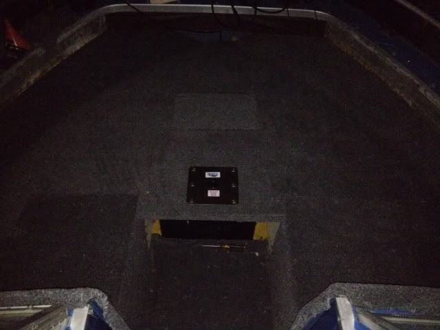

Just scored a Minn Kota Maxxum 55lb thrust trolling motor tonight. It's in super shape and is much more robust than my MK 40lb thrust motor. The shaft is longer, too(52" I believe). Now I shouldn't have any issues with the prop coming out of the water in choppy conditions.
Going to start the install shortly. The bow rail is going "bye-bye" to make room for the trolling motor. I've been wanting to get rid of the rail for awhile. I've never been n love with the looks of the railing...and it also gets in my way if I have to lean over the side to grab a fish.

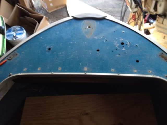

Got the powerdrive TM off the bow. Took off the fishfinder also. Now I'm trying to decide how to reinforce the bow piece. Currently, the bow skin is too thin and flexible to handle the torque of a trolling motor. With the powerdrive TM, if it went from off to full power it would flex the aluminum skin and make some noise as the boat started to move forward.
I can't decide whether to put a ply backer board under the skin on the bow....OR....put a carpeted piece if ply ON the bow skin. Putting the plate ON the bow will cover up the ugly holes in the bow skin, but it will also raise up the TM a tad...and id like to keep the TM as low in the water as I can.
I'm open to any suggestions on how to reinforce the bow area(inexpensively).

The more I think about it...the more I'm realizing that putting the plate ON the bow skin, is the best choice. That way I can rivet the front edge of the plate to the thick aluminum out edge trim. Problem is that the new TM shaft isn't much longer than the Powerdrive(maybe a couple inches) and the prop is much bigger...so I'm not gaining much length at all. I hate to eat up the measly length I've gained, with a 1/2" plate. I don't do a lot of trolling in choppy water...so I guess it won't be a big deal though.
