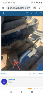

I'm guessing... mechanical?
And yes there's a mess of disconnected wires. Looks like 45 years of bare-minimum work.

saltchuckmatt
Jul 19, 2019
3,287
Yes, mechanical. You have a steering cable that is most likely froze up. Remove this nut and bolt and see if your motor turns without the cable hooked up. If it doesn't turn you probably have more than one problem.
