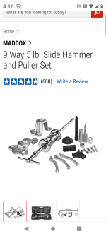

The marks are a concern!!! That cable has to come out. It has to go all the way through the tube. That is a precision fit so those marks will not let it go through.
Also, I said slide hammer, not air hammer.
Here is what your two options are now.
Get it going back and forth some how until it frees up and then maybe it can be cleaned up and used.
Or, option 2....cut off the other side, beat it through the other way and buy a new steering cable.
I've done many and it's common.
Here is a slide hammer.
