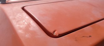

  • Went to re-caulk some rubrail/hull/deck gaps, and discovered several rubrail screws had come loose:
    • I was able to pull the rubber and tighten most of the screws. I had 3 or 4 that spun, but surprisingly all of them were in areas that weren't gapped. I pulled these screws and didn't observer any signs of rot (clean stainless, no staining or debris), but put them back in to avoid leaving holes
    • Did see a couple spots where it looked like screws had been removed and moved/redrilled 1/2" over. Maybe spun screws from the past?
      • It did look like there was a hole in the gel coat too. I might hit those with the UV4000 while I have it out?

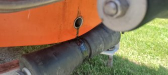

  • Bought supplies to remove and fill in the holes for this defunct pitot tube on the transom:
    • Plan will be to chase the holes with a drill, countersink the gel coat, then fill the holes with six-10 followed by a gel-coat repair kit.
      • Since pre-tinted gel coat for this boat isn't available (and I'm cheap), I'll be going the generic "mix it yourself" color blend route. Whatever gel coat I have left over will be used to patch various bits of dock rash elsewhere on the hull.
    • I don't ever see it being used since it interfered with the trailer (to the point of ripping and rotting the one bunk) and that I'm running a GPS speedometer.

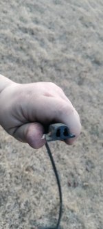

Looks like I'll get to reuse the old rub rail. This particular profile appears to be long gone... modern rub rails are completely different.
Hoping a warm day and some silicone spray/paste will do it. Will likely put up a fight... it's a very "solid" profile:

You can still find the rub rail, but it's not cheap. If it's not too far gone, I found the easiest way to reinstall them is soak the rubber in a big 5 gallon bucket or storage tub filled with hot water and some dish soap. It will make it more pliable and lubricated. Feed it into the rail directly from the bucket and use a needle nose vice grip on the leading end to give you something to help pull it along. Helps to have an extra hand, one to feed and one to pull, but I've done a few by myself as well. You might have to work a little to get it stretched enough to rivet it back in place using the original holes, but it doable.

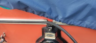

Got it installed today. Other than stretching it to fit at the end (which I was able to use the existing holes and the screws to help pull and anchor while staking it down in the track), it went without a hitch. Installation was not the reverse of removal, as instead of trying to fold the lips to the groove, I instead shoved it from one end around the perimeter of the track.
Other than teasing it past the aluminum rail junctions (where there is a hair of factory misalignment), nowhere near the fight I was expecting.
Whew. Better yet, I didn't need to buy a new one!
