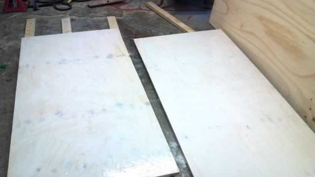

This morning I got the transom glued up. I still need to cut out the final shape but that will be tomorrow after the glue sets. I might go mess around with the star trek a little now.....
Glue on both faces for good adhesion.

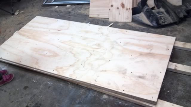

Both boards together, I screwed it together with a bunch of drywall screws. I'll fill those holes in with thickened epoxy when I'm ready.

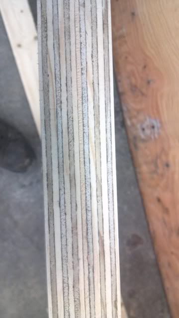

I had good glue squeeze out all the way around. I checked it with a straight edge and it's within 1/16 of an inch. I believe that's within Mercruiser specs. I used Titebond III waterproof glue for the glue-up.

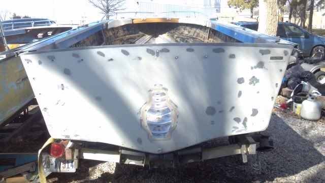

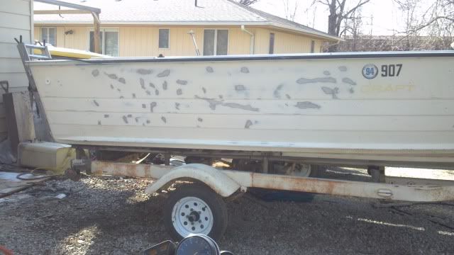

I decided to do a little sanding on the hull. I was using 80 grit on the orbit sander and it worked really well. I feathered out the edges on any scratches or chips to try to hide them when I get the final coat of paint on. I need to get some marine tex to fill in the holes from the speedo pitot in the transom. I plan on painting the transom before bolting anything up so I have a nice smooth layer of paint. After that I'll install the transom and get it flipped to paint the bottom. I still have a ways to go before that step since I want to get the glue and carpet remanants off the inside and I need to get the gluvit down still.

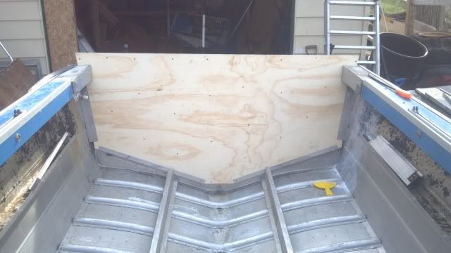

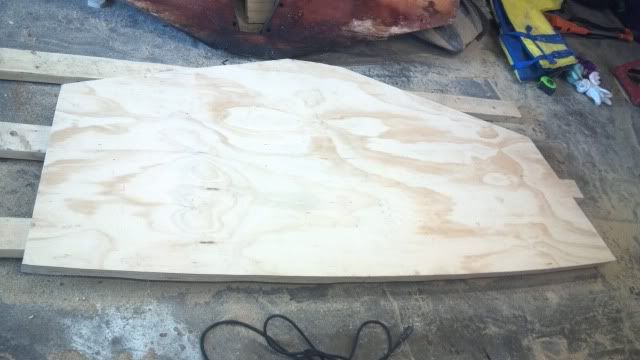

I got the transom cut out and test fitted today. It turned out pretty nice. I still need to cut out the keyhole but that shouldnt take to long.
Crosscut looks good.

Re: 1977 Starcraft Supersport
The angle of that last pic makes it look oblong but I assure you its not.

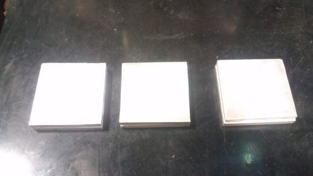

I made some backing plates for the stern towing eyes. They are 3/8" thick and 4" x 4". This will help keep the nuts from sucking into the wood. Ill make something similiar for the bolts running across the top.
