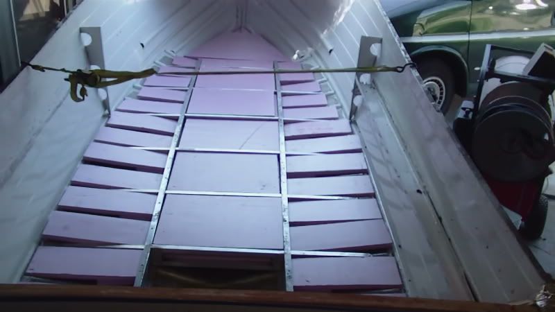

OK guys. Just went out and attempted the foam. How did you guys do it? I've got one 2" thick piece resting on the ribs inbewtween the stringers at the moment only thing is that leaves a ton of space below. I'm thinking I'm going to need a 1" board as well.
So question really is, is how did you cut up the foam board(if you used it) to fit everywhere, and how was your layout? I really just wanted to do it all in big chunks, but that might not give me enough flotation? I'm sorta confused, and I want to get the deck down today.

This is what I have so far today... :facepalm: I should have the deck in by now, but this foam just has me thinking too much. I have it all the way up to the bow now. But this is still a pretty sad showing...
Is this going to cut it? Should I add some smaller pieces under the ones in-bewtween the stringers? Also what should I do about the sides? Maybe cut it up into smaller strips? I don't know why I can't think right today. Just need some opinions. I thought this wouldn't be too hard, and had an idea of it in my head...
Huron Angler
Apr 7, 2009
6,025
Re: 1978 16' Starcraft SuperSport Resto
Looks good so far, don't stress about it. Just fit as much as you can and you will be fine.:)
I added some noodles on the outer edges and with my ski locker being open I don't have as much as some folks. I have enough to float the boat and that's all that matters.
Keep in mind that gas tanks, life jackets, and coolers will all provide additional buoyancy if you get swamped, as long as they are held down in some fashion. Do you have foam boards behind your side panels too? That's my plan when I replace mine.

Here's how a fellow iBoater did his...
OK Thanks Huron! I really have no idea why I'm so stressed out about this foam... Ohh well I think I've got it figured out.
My side panels didn't have foam behind them. I may think about it, but that will really depend on if I have much foam left over.
Thanks for posting the picture WNG! I was trying to look for some... Yet, as always when you look for something you can never find it.

So much for the nice weather :facepalm: It's a really crappy day... So far today my rivet gun has broke, and my caulking gun doesn't work. I'm about to call it a day right now. I may go back out and work. I don't know, really don't want to mess anything else up.
Also what's worrying me now is that the deck is going to squeak every time because of the foam underneath. Any suggestions? I wonder if the squeaks will go away if I get it down good enough...
I know how ya feel BG, I have days like that and I am not against taking a break now and again to clear my head:)
As far as squeaking, I had concerns as well. My theory was that if the pink boards are laying so that they are 1/8"-1/4" higher than the stringers...when the deck compresses them down there will be no wiggling or squeaking of any sort.
So far that has worked very well and I have zero squeaks no matter where you step, or how heavy you may be. Also the pool noodles don't squeak at all, and I used quite a few of them with the foam.:)
Exactly what I was sorta thinking. Glad to hear yours aren't squeaking! I'm just going to add a bit more on the sides of the stringers so that it will all compress down. Thanks Huron!
