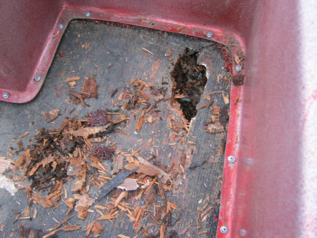

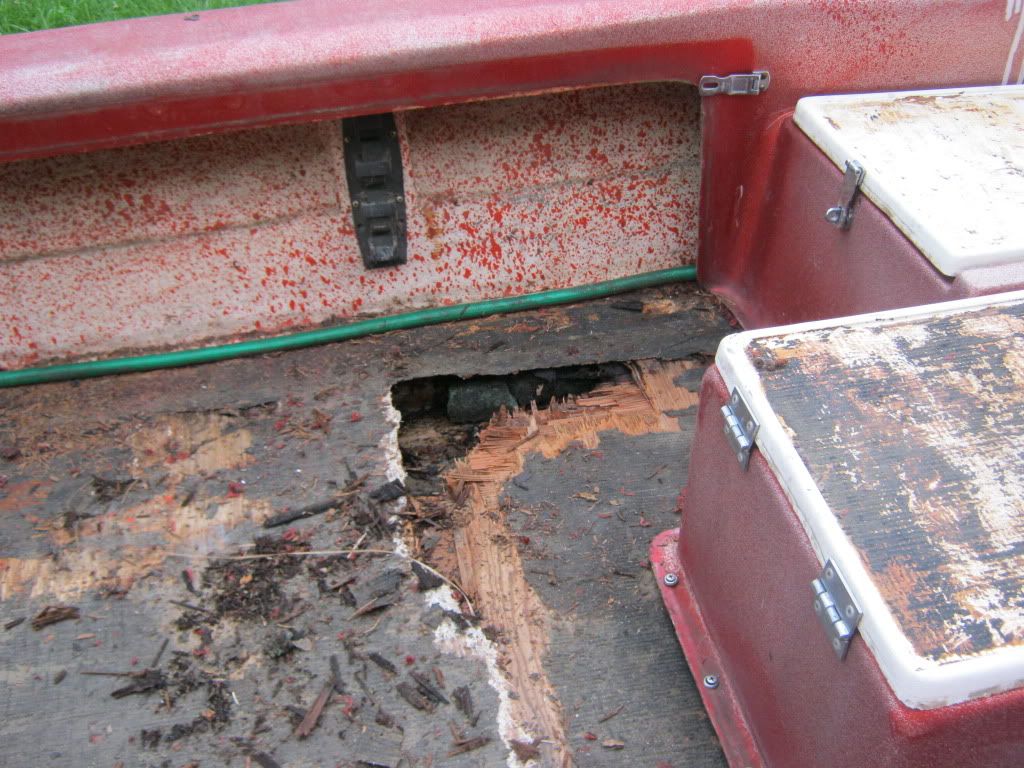

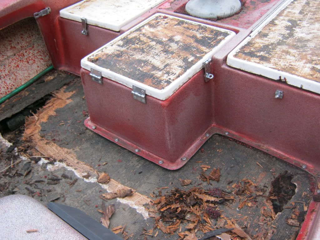

The issue I am worried about is the floor near the bow. I originally planned on living with the problem and tackling it once it go worse but this board made me change my mind. I have since torn into the completely soft sections but the problem I now face is how I can replace the front of the floor without major difficulty. I don't have the means or money to doing anything major like splittling the boat. Is it possible to replace those front sections some other way?
Oh, the good news I found so far is that the foam isn't really waterlogged. I'm not sure why it isn't, but all I found was very light foam with little to no water in it. Also, I have noticed that the majority of the floor is very close to the hull and when I felt of the short stringers (I think it was anyway) it was very hard with no give whatsoever.

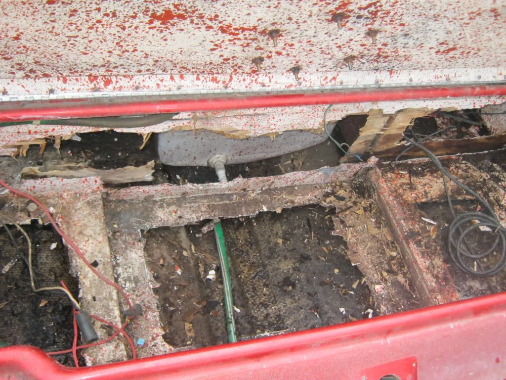

Based on your pics, I'm afraid you are going to have some major repairs. It appears to me that you will need to remove the entire deck. If there is ANY water below the deck and in the foam, IT WILL NEVER DRY OUT and it will need to be removed. The stringer may Appear to be ok but you will need to drill into them to be sure. if you get light tan DRY shaving then OK if not then THEY will have to be removed and replace and THAT means a LOT of work and MORE expense. SORRY but this could be MORE than you want to deal with.
