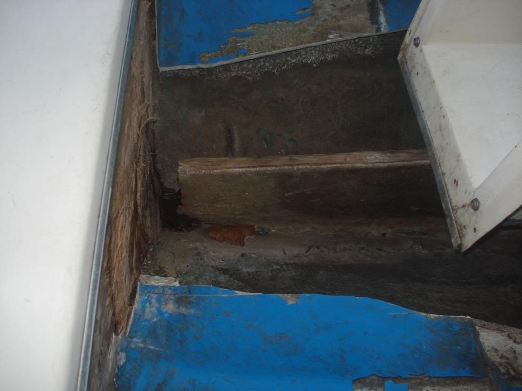

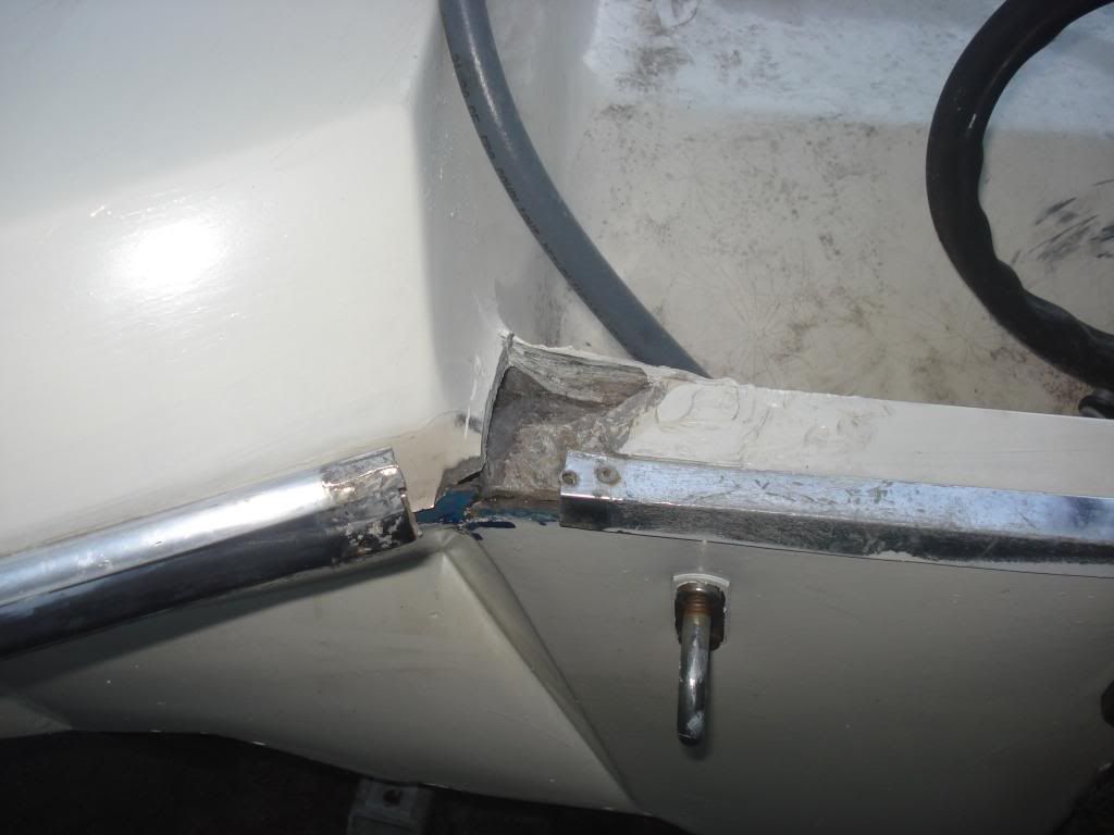

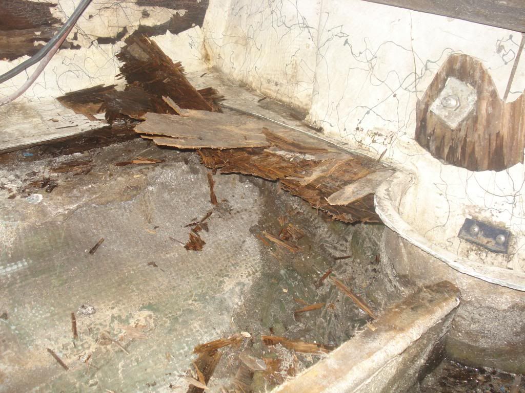

Hello everyone, I new to the site and need some help with some work on a friends boat. He just purchased a glastron and it is in need of some love.

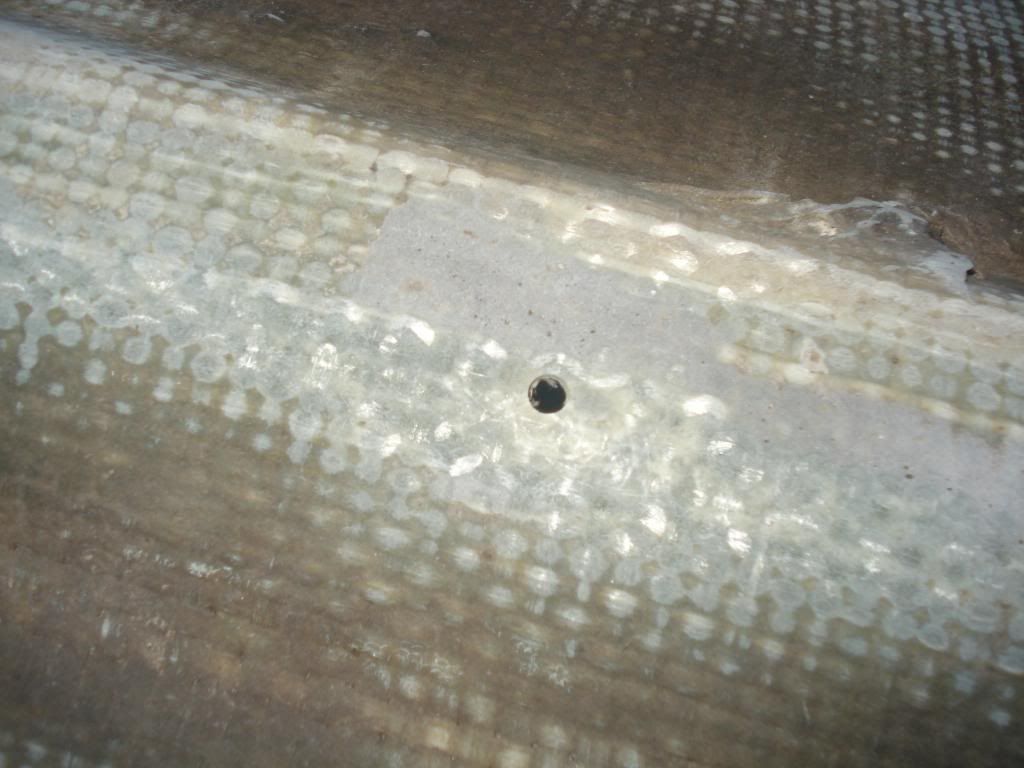

The previous owner layed a new floor over what was there and when we pulled it up cause the screws were rotten that held it to the stringer, we noticed a drill hole thru the hull so another fixed added to the list.

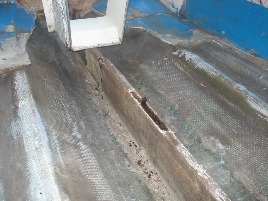

We are going to replace the stringer, floor and the transom needs some fixing. Its just the fiberglass that needs repair as the wood is still good cause we did some core checks on it and was still solid.

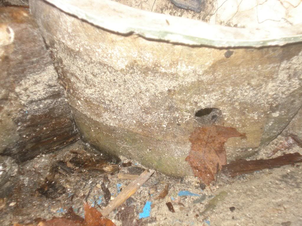

The stringer is shot so we have taken that out along with the whole floor. I have a few ? about the bilge as I noticed that there was two holes drilled into it but were up high and if water go under the floor how is it surpose to get out.
I will post pic of what needs to be done and really really really would like some help to have it done as best as we can. I have experience with working with fiberglass from work, but not restoring boats so laying glass is not a issue. I just need to know what to use were on the repair's.
I have done a lot of reading and have ideas on what needs to be done but just want to be sure. It only going to be used as a fishing boat to have fun as we are sick of land fishing. Well hear are some pics of what needs to be done.......

Lots of options. You can cut the splashwell at the gunwales or you can remove the cap to get to the transom. The center Keel Stringer appears to need totally replaced. You can use ext. grade plywood for both the stringers and the transom. I'd recommend Polyester resin for the rebuild. These two links will be helpful for you...

Yes we have core checked the transom down low and was still good, wasn't mushy like the stringer was. As far as the stringer were going to use the 1X as the longest piece of plywood we can find around hear is 8' and would need a 10' so would have to add 2' to it and that would be more work. I really appreciate your help and I am trying to stay by your suggestions and the link you have provided. Yes we plan on foaming the hull once the stringer in and all glassed up and for the bilge there is only one hole in the transom for the bilge to drain but the hole's for it to drain from under the floor into the bilge are about 3" from the lowest part of the hull. That why I asked if we should plug those and drill two holes on either side of the stringer along the lowest part of the hull to use for if water get under the floor in can get out thru the new holes. If you look at the pic above you will see how high the hole was in it for it to weep into the bilge and it never got all the water out so that's why the boat rotted out, I'm just worried about when you rinse the boat water will run thru the new weep holes and under the floor and stay there. Sorry if I sound dumb as like I have said I don't know anything about boat's and this is all new for me.
