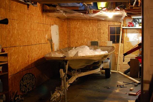

Well you could strap it with a few braces and go slow....it should survive.
Use a few pieces of wood inside and run a strap around to keep it together. Be careful of the bottom that you do not develop a hook in the hull
