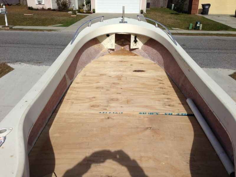

Here is a before-photo of the deck, prior to tabbing, glassing, and all.

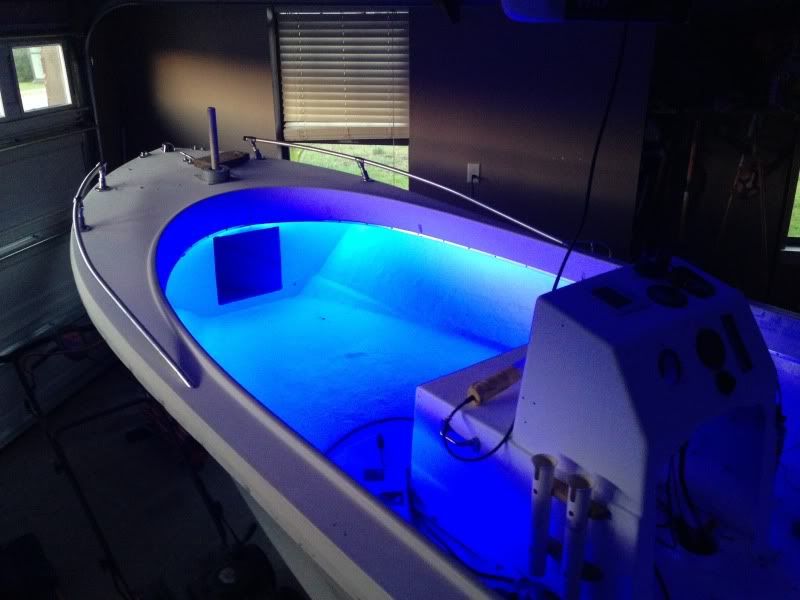

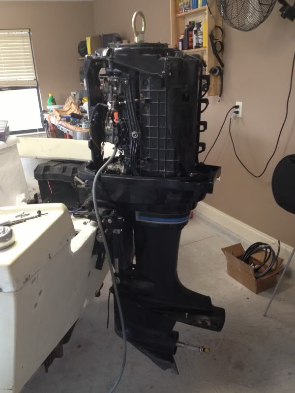

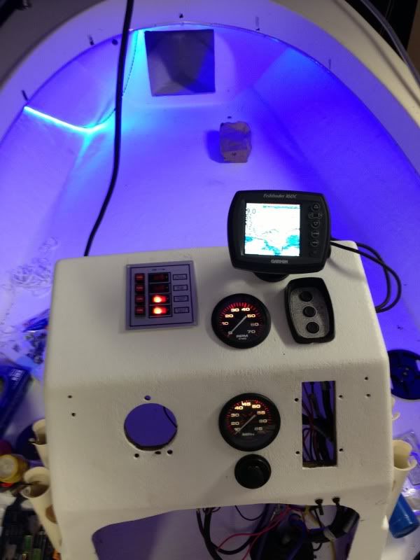

Well... here is a quick update with a few more pics. I have completed all of the electrical wiring and have all of the necessary components running sub-deck up to the helm. I have the motor mounted on the transom. Which as it turns out, the motor was previously mounted about 2 inches to the right of center on the transom. I measured and placed it back dead center... This may have been a cause of why the boat planed so poorly and would never turn as it should... I will find out. I also have the Trim/Tilt hooked up and operating correctly, and now I am concentrating on the steering, which has been the biggest pain so far. It is difficult trying to push the steering rod through the motor mount and only goes in about 1/8" at a time. I was able to get a small pipe wrench on it and twist/turn/push and get it through quite a bit easier, but I still have about 3" to go before I can get it hooked up.
I have been spraying some Deep Creep into the cylinders the past few days, and plan on doing so until I get it ready to fire up... I need to replace the impeller and work on a nice sea-foam/2-stroke gas mix to run through it before I can call it G2G... Anyways, enough with my rambling... here are the pics of my "oh so close" work in progress.
