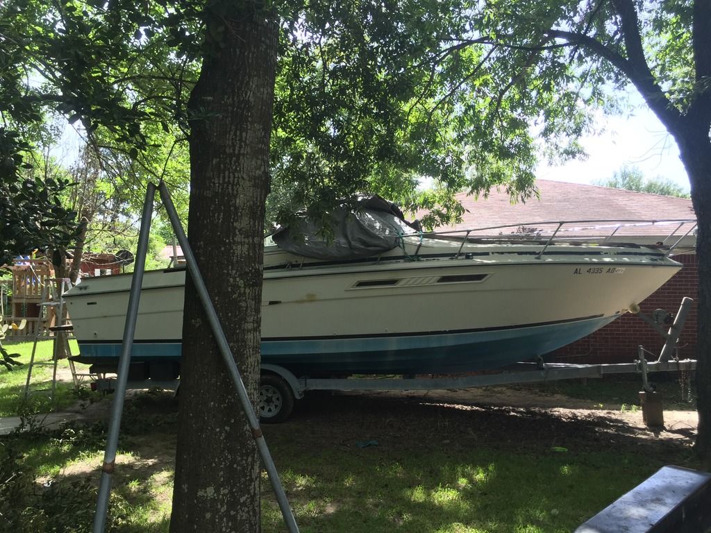

1978 Sea Ray SRV-260 with twin I/O Mercruisers, cleanup and replace whats needed...
Rick Stephens
Aug 13, 2013
6,118
How much you all think I'm going to need in supplies and approximate cost
