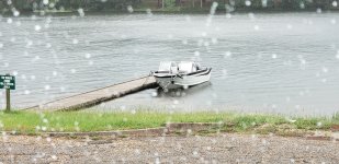

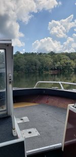

Took her out for a shakedown this morning/ afternoon. Things went well. No leaks (as far as I can tell), motor ran smooth (a little bogging when getting on it but I think a carb rebuild will solve that). Typical Mississippi weather had us sweating like crazy before dumping rain on us for an hour. Bimini top is going to be a must- have. Got to go out again after and did a little fishing (and caught a little fish lol). All in all I think she'll do as is for now and wait till the cold before I open her up and start resto.

Man, that is an interesting way to mount a trolling motor. I am guessing that will get replaced.
SHSU
24Robm
Aug 29, 2021
30
Lol....FIL rigged that up many moons ago. With the boat came an actual trolling motor mount and wedges. That's one of the many things to be added during the restoration.
