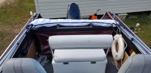

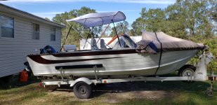

Baby steps (I feel like a toddler next to what y'all are doing lol) but winter's coming here soon and I'll be able to start drilling, filling, sanding, and painting!!! The General surprised me with an early Christmas present and gave me a much needed bimini. We still have a month or two of good water weather and the shade is a blessing. We're going to wait until we're out this weekend and adjust accordingly.
