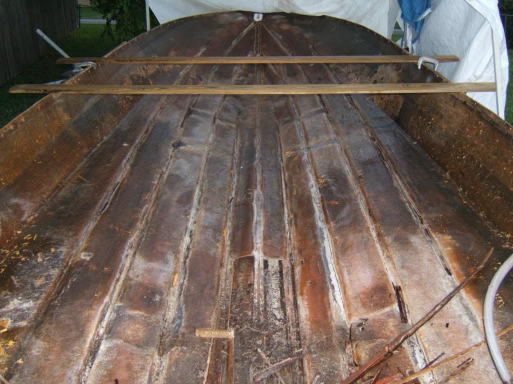

Some more progress today. The stringers were not rotten all the way, wet but not rotten. As you can see in the photo, they also used a single piece of wood, not plywood. The one on the right popped right out, the left one had to be chiseled out. The hammer drill was a life saver here - love that thing. The only way was to chisel it out in small strips, it took about an hour.
I'm thinking of writing a weight loss book,
Step 1. Put on Tyvek, seal cuffs and grind/cut for 4-5hrs -I just gotta stretch that out to 200-300 pages and I got a winner!

I got a later start than I wanted, but got some more progress, the clock is ticking. I have 1 month, to either finish or get trailer/transport ready.
The sawzall is an amazing machine, I don't know how we lived without it. I cut out the transom and the remainder of the deck and foam. I'm trying to salvage the thru-hull boats, but those nuts are rusted on ultra tight, any suggestions? I'll spray em with bolt-off in the am and let them soak before I try again.
I found this string all through the lower decking and transom, they put strings of roving woven in the plywood, makes it tougher to get the wood out, but I can't imagine 5-6 threads across the width would do anything...other than annoy me.
You can see here they got a very good bond of wood to glass. The wood is still so wet that it cakes the sanding pad in 3 minutes, so I'm letting it dry overnight before I try again.
