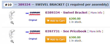

Thanks all. Does anyone know the difference between the part numbers shown here, other than cost?
