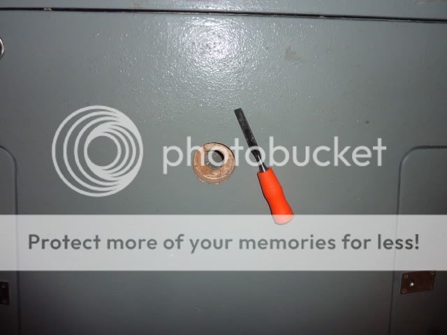

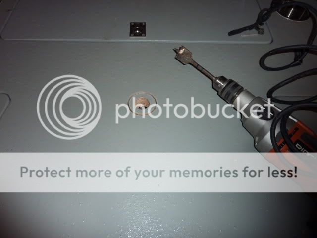

First, I drilled (partially) out a 2 1/2" hole...
(Yes, I was drilling over my fuel tank. Yes, I was a little nervous. Yes, I measured and double checked like 10X.)
Then a 1 1/4" right on through...
Then I basically chiseled out the outer wood ring...
Next...

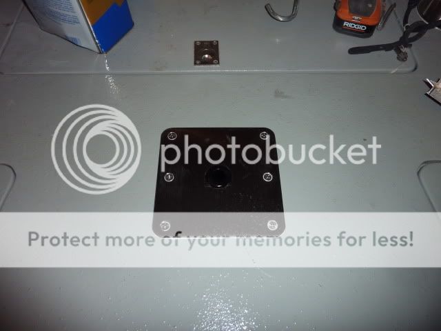

After that, 5200 all over the place (though I did manage to get some on my work pieces)...
Installed with SS and all cleaned up...
Assembled the seat, popped it in, took it for a test drive, love it!!
