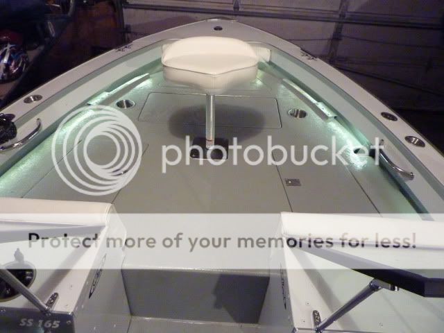

Assembled the seat, popped it in, took it for a test drive, love it!!
:thumb:
Good work again. the lights set off the front pedastal... Did you turn that on just for the picture? Come on man... Friggin showoff.. :yo:
HA!! Yah baby!!! I love those lights!!!!:humble::humble:

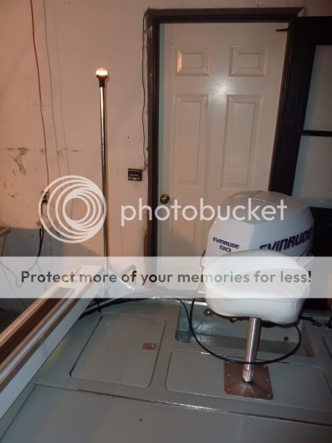

Allrighty, stern pedestal seat installed!
Feels like a great fit back there - perfect spot to reach the trolling motor and legs fit real comfortable on each side:thumb:

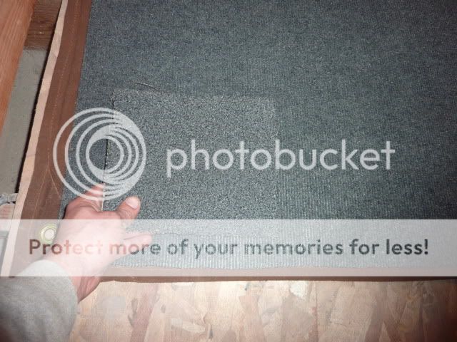

Allrighty, so how about an update on the snap in carpet.
I have seen the cash that can be thrown into this kind of job and I was/am intent on figuring out a way to do this reasonably.

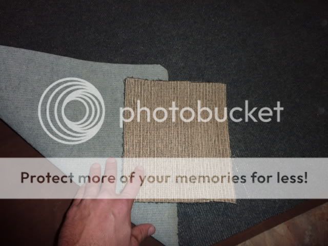

So, I grabbed a roll of outdoor carpet from Lowes. I got enough to finish both the Sea Nymph and the Islander...
Cheap! I'll probably have about 35 - 40 bux into material here for the SN. I was going to go with "Marine Grade Carpet" but honestly, I really couldn't detect a marked difference that super expensive stuff and this. Here's a sample of the "MG" vs. the stuff from Lowes...

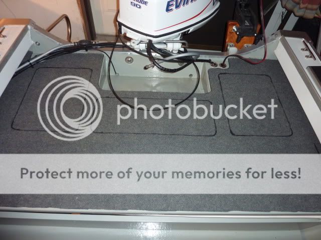

Here's the stern deck piece rough cut and getting the hatches marked off...
Everything trimmed up...

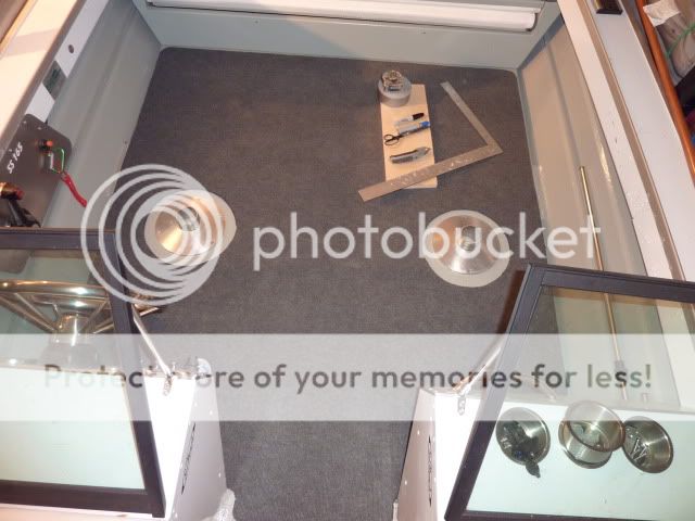

Then on to the cockpit area...
Tools for this job were pretty simple - straightedges, Sharpie markers, utility knife and heavy duty scissors.
All I basically did was trim fit the piece and lay it down. Then I just ran a smaller Sharpie in the seam of all the hatches marking the cut. One problem was the inside edge of the hatch cut needed to be bigger so the hatch could clear. So, I went back and traced the mark with the Magnum...
I love that monster fat marker!
So they look like this...

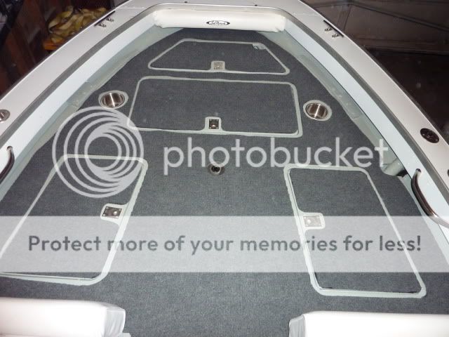

And all cut out...
OK, all ready to drop off at the Tent/Awning Shop for binding tomorrow:thumb:
Have an excellent Sunday gents!
