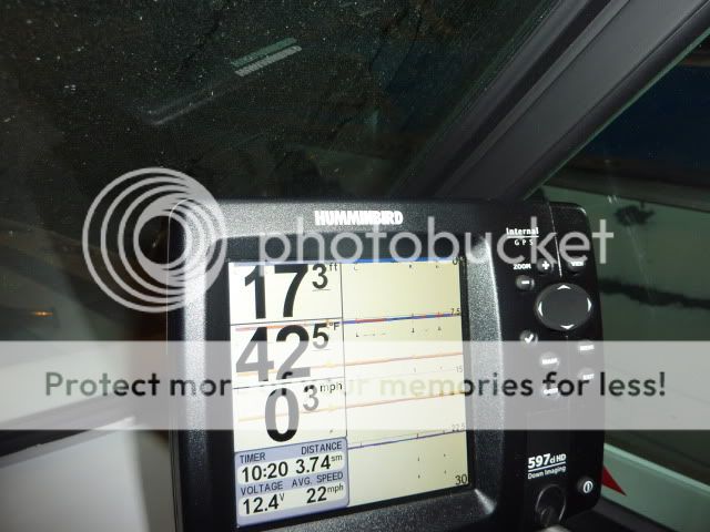

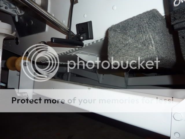

On the transducer, I just kinda went ahead and split the difference between the two chines, the bunk and the engine. I think I should be just fine...
Made the connections, powered up, nice!
I wasn't marking any fish in this spot so I called it a day.:fatigue:

Install looks good J.
Switch that thing over to simulator mode and you'll mark some real nice fish, simulator mode is where I've marked some of my biggest fish!

I was going to suggest one of these in case you ever wanted to add or change things,....Keeps holes through the boat to a minimum,..
Cabela's: Cabela's Transducer Mounting Plates
It looks like you mounted it in the best place,....It's where I would have put it so it must be!!!!,.......
