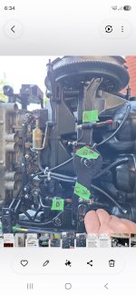

Good morning everyone. I'm working on this high-performance "Franken-motor" hybrid build. and backing de current design from a racer that was set to perform at somewhat I guess design and locked at 22deg BTDC and the intent now is to roll some of this back. it had a different flywheel added the wrong flywheel cover the timing pointer missing. after intense reading / consulting I was able to get thing all done accept for one possible missing trigger advance linkage assembly. if you look at the picture is there a linkage missing from the trigger beside D and the actual advance arm A? reason I'm asking after finding TDC moving the flywheel literally pulling the flywheel off and moving one hole over = 1 x 45deg to point to my new timing pointer and trimmed the idle to 2 deg BTDC for now sparkplugs out grounded properly constant voltage to starter to maintain a true 300RPM to perform timing and trottle cable disconnected when I manually move Arm C forward Arm A does not and online research suggest I'm missing a linkage rod between A and the trigger advance assembly is that correct?

"reason I'm asking after finding TDC moving the flywheel literally pulling the flywheel off and moving one hole over"..
don't know what you're workin' with but this CANNOT be done with any V6 merc... tha flywheel will only go on one way and one way only no mater tha flywheel and/or crank... below is dia of all tha parts you need in relation to what you're workin' with... if ya took tha center hub loose and moved it then ya gonna have a big problem..... tha magnets in tha hub are "clocked " to work with tha magnets in tha flywheel as an assembly....

flywheel is a flywheel no mater for racing and/or stock.. in any case if tha center hub is clocked different than its supposed ta be it will never run right period.. you cannot change tha "hub" position on tha crank.. its a one and only position.. i'm having a hard time visualizing jus what you are doin' and which parts you are talkin' 'bout?.. "C" arm? tha control is actually two parts.. tha bottom is for throttle and tha top is for timin'.. tha bottom has more travel than tha top.. thats where you adjust ALL timing, both idle and full advance....
think best thing for ya is to find a OEM manual for it and do some serious reading....
