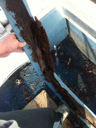

One soft spot is usually indicative of a lot of rot...

!...is it metal or glass?.....if its metal..it will be a cake walk to restore, compared to the more beautiful, more seaworthy, more elegant, more easy to get chicks in, nicer, more common, more socially accepted, more politically correct, fibreglass boats
