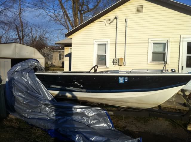

I know this is way to early to start thinking about paint, but oh well. I originally was just going to repaint the stripe on the boat. When i got the boat i only planed on replacing the floor from the steering wheel back, but now ive decdied to just gut it all and redo everything to where it will last while and look nice. So once i get the inside stripped out i think im going to go ahead and build a motor stand and pull off the O/B and flip the boat and smooth it out and make it look good.
Question is how much do you guys think it would cost to paint it. I know prices may very im just looking for a rough estimate for materials. im going to attack a picture for how i want to paint it. i would just like to roughly know how much material cost id have in paint before i decide to do a full paint on it.

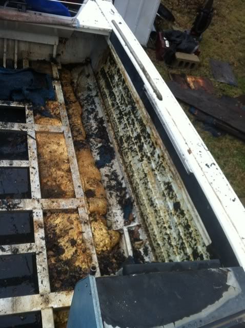

On your engine, Post #20, Picture #3...the only issue I see, and I could be completely wrong, is the spark plug wires look like they have some cracking of the insulation.
IF, that is the case, you MIGHT have a performance issue with crossfiring, meaning that if the engine seems to misfire or stumble at any time, whether idling or under power, you may want to consider replacing the wires. Just a thought...:redface:

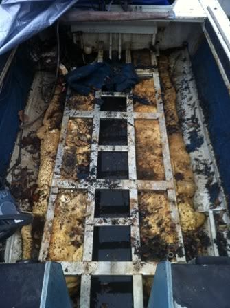

Well guys spent about an hour or so today on the boat and tore the floor out, minus the front floor, from the consoles back there's no floor. The floor was actually 4 peices which made it somewhat easy to get out. I just started picking at wet spots and holes and started pulling up pieces haha wasnt the best method but it worked!

Looks like you have the dreaded poured foam, jp. :eek: The stringer system looks substantial.

Save the pieces of deck wood to use as templates for your new plywood. For new plywood, I would go with exterior doug fir ply and seal it with epoxy or poly and glass. Arauco ply, or what it's made of radatarian (sp) pine, is not as rot resistant as doug fir. Even if you seal it up it's going to be more susceptible to rot, any staple or screw hole not sealed up will allow moisture in, then the rot begins. I do agree that Arauco is some nice looking ply, but I'm not sure of the rot factor, long term. If Plydek XL is available in your area that might be a good choice for plywood as it's a treated marine plywood, used for pontoons and boats. It's kind of spendy, but you don't "have to" seal it up with epoxy or poly and glass. Oh yeah, don't use normal green treated plywood, it'll eat your boat.
That foam looks water logged, and with the condition of the wood, that would make sense. Do some core samples (piece of plastic pipe with teeth cut on the end, twist down into foam) and see if it's water logged. If it is, rip it out and replace it with sheet foam or EZ's favorite, pool noodles.
To remove the residual carpet and glue off the aluminum, soak some paper towels in lacquer thinner, lay them on the fuzz/glue, then cover it with a garbage bag so the lacquer thinner doesn't evaporate quickly. Let this marinade for 15 minutes and the stuff should easily wipe off. The fuzz areas might require a second treatment as the thinner isn't laying right on the glue. I bought a 5 gallon can of lacquer thinner for my project and used most of it. I would do a test spot to make sure this works with your glue, before buying a 5 gallon can. ***CAUTION!*** use a respirator and plenty of nitrile gloves when doing this. I doubled up the thin nitrile gloves and when the top one shredded, I'd put on another. Harbor freight has nitrile gloves pretty cheap, I'd get 2 boxes. (I tried a set of heavy "dipped" nitrile gloves, but they only lasted an hour or so. The tin ones worked better, even though the lacquer thinner eats them pretty quick.)

The floor is in to many pieces to use as a template, there was so much rot i couldnt get it out in big enoguh peices to save for a template. I work at walmart so cardboard is easy to get for free so im just going to lay down cardboard and then trace the template on to ply wood.
Most of the foam is no good, its real soft and water comes out when you touch it lol
I might have to do the floor in pieces because the consoles, are welded to the boat and i would rather not break the welds

You might want to remove the bung in the transom and get the bow pointing a little more skywards to drain off the water laying around in there, bet that smells devine :D .....if you cant get it undercover its good practice to keep it stored that way too, tarped or not.

I raised the trailor as high as it would go and got a few gallons of water out lol, then i lifted the boat in the air for awhile but i got tired of holding it lol
