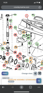

My bad, in post 28 the bolts I was referring to were the ones holding in the zinc anode above the trim tab and the long bolt just outside the trim tab. I thought those were it, but according to the parts list attached to my serial number on CrowleyMarine there is another bolt hidden underneath the trim tab. The trim tab is stuck due to the rounded bolt.

I doubt you will find a hidden bolt under the trim tab !
Ah I think you’re right. Looking at the diagram again Part 79 wouldn’t reach all the way up to the exhaust housing anyway.
I think we are stuck then, because all 4 main bolts are out (one broke in half), Part 68 (long bolt) is out, the anode is out, and the shift rod is detached under the bottom carb. It must be fused to the crankshaft as was suggested earlier 😔
EDIT: Unless Part 79 is set in a recessed cavity, which is entirely possible - I am reading around some forums. On a ‘92 Johnson 150 people were advising to remove the trim tab to reveal a hidden bolt…

Certainly not.... I messed up on my 75hp mistakenly unbolting the anode(#75) and snapped the head flush. Unable to hacksaw the the bolt (no space) I resorted to drilling out the anode till it broke apart ...got a new one from Amazon.... ( 2 types of metal for the anode.....and of course I ordered the wrong one... thankfully Amazon shipped me the other kind and.. I got a freebie. )

Correct. Here are some pics of what I’m dealing with. Guess I’ll try applying heat because getting a drill in there at that angle would be tough.
I’m leaving the trim tab alone for now since I’m hearing there’s likely no bolt under it.

if all else fails... & that trim tab seems to have a hole in it already..get a sharp chisel. and hammer it should split being soft metal... access the bolt head to work on it .. but a new tab and bolt if the GC can be dropped
