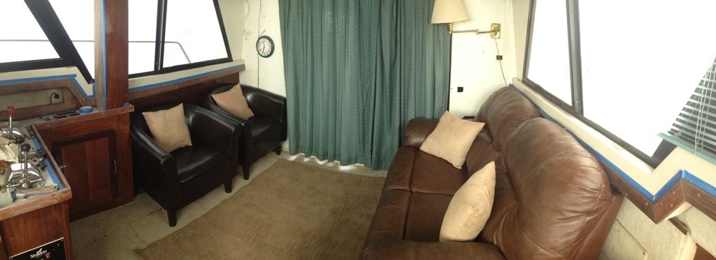

Re: 1984 Silverton 34C Remodel/Update/Upgrade PIC HEAVY
Got things put in and still going on the refinish work.
Panorama view!
^^^ Looks like a right nice spot to relax after a good dinner afloat........ Nice work, really nice finish work. :cool:
BTW: I really like the blue accent stripe :facepalm:
Thanks! Accent stripe stays until the varnish is done. :D
Lookin good.
This pic screams nap central.
Thanks, that couch is a double recliner (wall hugging one as well) so it's definitely going to be a nice place to relax.
The Helmsman does look good, but after a side by side, the more expensive Interlux and Epiphanes varnish does look better. I will probably stick with the helmsman as it builds coats fast enough and doesn't dry up to form a skin as bad as the other varnish.
