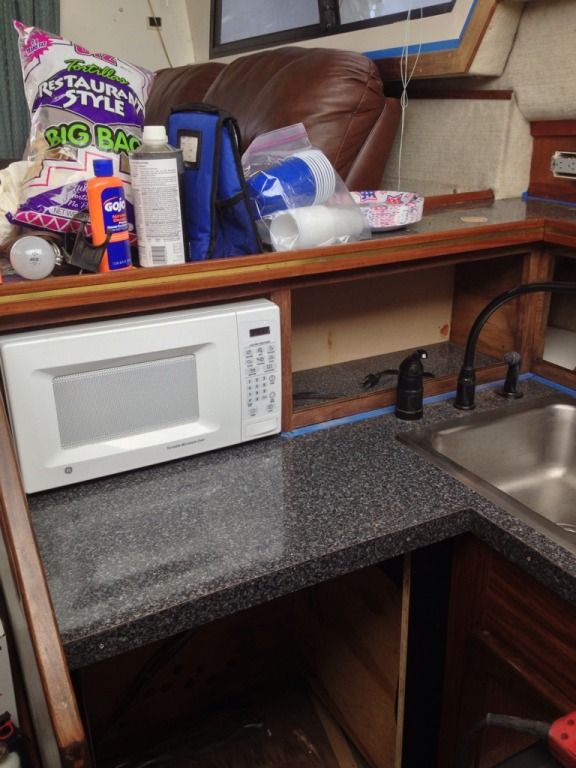

Decided on a whim to move the microwave from on top of the counter to under the shelf at the salon wall. A million times better and took about 30 minutes to do.
Old location from day one:
Now:
