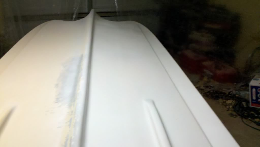

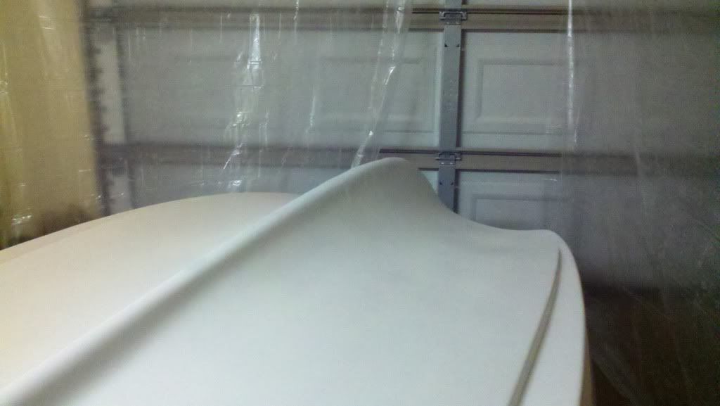

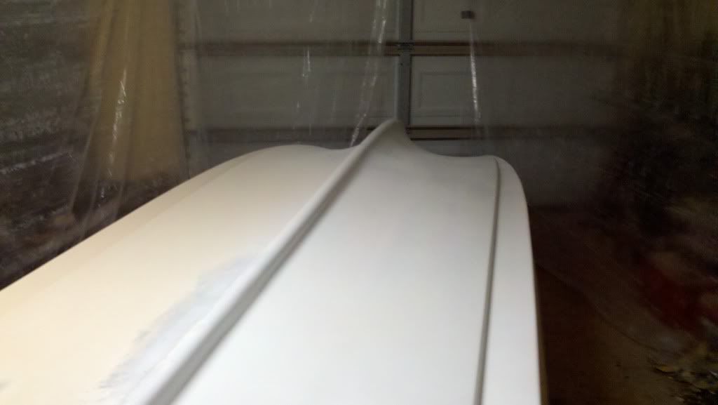

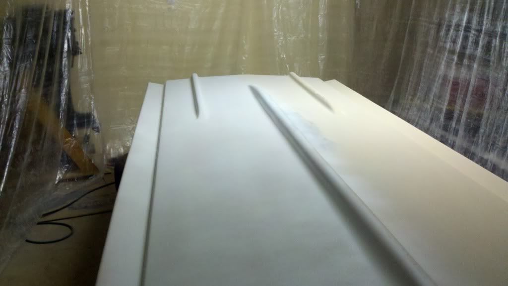

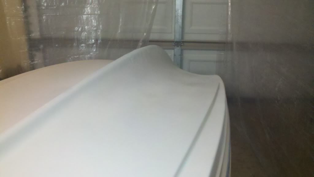

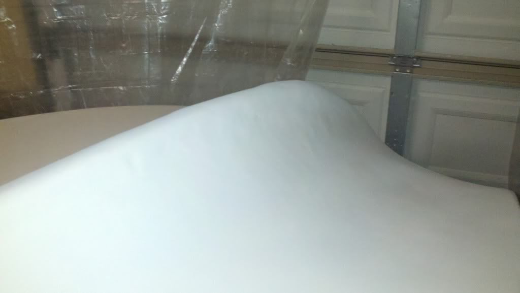

I didn't let the rain slow me down too much today. I prepped the garage, finished prepping the hull, and started to prime it. I thought I had more primer left than I actually did (thought I had 3/4 can but only had about 9oz) so I only managed to shoot about 1/4 of the hull. I did manage to make a pretty good gas chamber, though! I forgot to put on the respirator and in the short 5 minutes I was shooting this small amount of primer, it was getting to me. Whoops!
Not that I had any doubts or didn't believe it, but the primer really shows all of the remaining dimples and scratches that I chose not to fill/fair. I'm still ok with it and I'm not going to try and redo any of it, but it's definitely visible!
I'll pick up a couple more cans of primer tomorrow and finish up the first coat and put the finishing touches on the trailer. The second coat will go on Thursday. My first coat of color will go on Friday with the next coat going on Sunday morning. The chance of rain for this week has dropped significantly so as long as it holds true by Thursday, I will be shooting color on the trailer as well.
I've currently been buying the Rusto primer by the quart, but I'm starting to think that maybe I should return the two quarts of unopened color that I currently have a get a gallon of white and a gallon of red. If for no other reason, it will mean I will only have to mix my maroon color once and be done with it instead of mixing it multiple times and hoping I get it exactly the same each time.
It's nothing special, but here's the pictures of the partial primer job on the hull.
