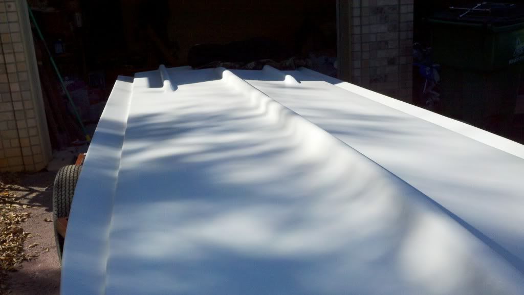

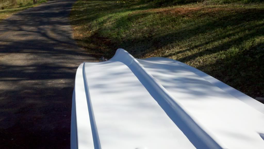

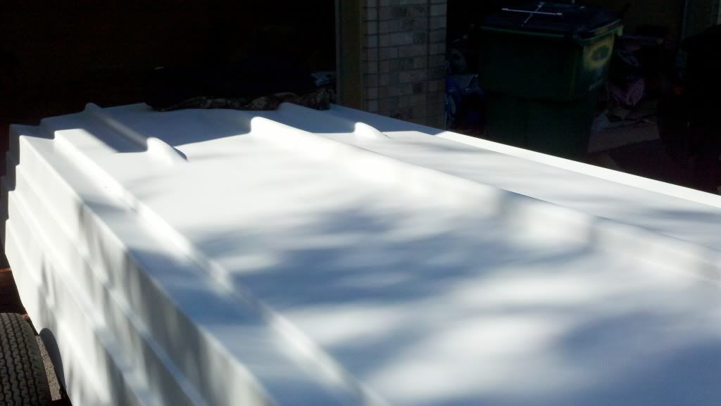

We got back from Missouri late last night and today the wife informed me that it was time to go cut a tree and start decorating for Christmas. Needless to say, I didn't meet my deadline on painting. It didn't matter much, though, since my brothers weren't able to come in from Nevada to help me flip the boat back over.
My wife and I pondered the options and we decided that we would put just the tires and the jack back on the trailer, hoist up the hull, and set it on the trailer still upside down. It actually went off without a hitch (normally, our ideas never work on the first try!) and I was able to get it on the trailer and out of the garage in under an hour.
I haven't done any work on the boat since I sprayed the second coat of paint on the hull. It's got a little bit of orange peel (is this normal or do I maybe need to thin my paint down a bit more?) so I will wet sand it with some 320 before I shoot the 3rd coat and then again before I shoot the 4th (and any other subsequent coat). I'll finish it up with a 600 and a 1000 wetsand before I buff it up to a shine.
Anyway, the plan is that when I spray the subsequent coats of white, I'll hoist the hull up and put the plastic down on the trailer so that I can keep the hull on the trailer and shoot it outside where I have plenty of room and then wheel it back inside to dry. Kind of the best of both worlds for me.
Painting the new maroon on the trailer will be a bit trickier. I've almost decided to just roll the trailer so that I don't have to worry about all the extra prep work each time I put a coat on it. It should be as simple as hoisting the hull, rolling the coat, and setting the hull back on it after it has dried to the touch. I know I'm not supposed to put anything on it until it has fully dried, but I have looked at the contact points of the hull on the trailer and the only point that the hull touches a visible part of the trailer is up front... but even then I believe it is right where my winch support connects so no big deal. Where the hull rests at the back is the two steps supports, which are covered with wood/carpet so again, no big deal.
These pictures are the first pictures taken of the hull in natural light with its new color on. It's not shiny or anything (since I haven't done any sanding/buffing), but it sure does look pretty good! In the garage, you can still see where the "repairs" are, but out in natural light they almost disappear; unless you look up close and are actually looking for them. Once it's buffed to a shine, they may become even less noticeable! Tomorrow it is back to the grind on the project and seeing the hull outside of the garage gave me just a little more spark to get going!

looking good man, it is amazing what a coat of paint can do for ya!

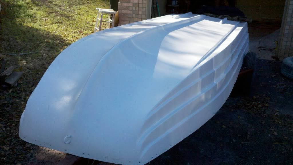

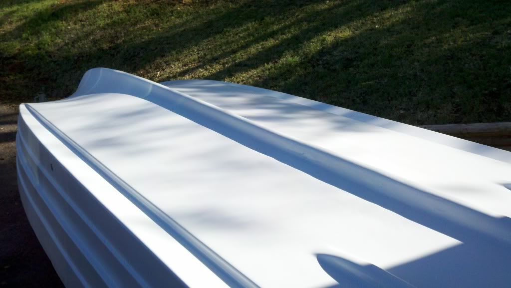

Well, I haven't touched the boat since Thanksgiving so I decided I better get back out there and do something. I finished wet sanding the hull with the 320 (and think I may have gone too far on one side). I'm going to put at least another 2 coats on it with a good wet sanding in between coats. I want to have a good, thick layer of paint on it and as smooth as I can get it. That will be for another day, though. I have to get the trailer done first!
I hoisted the hull back off the trailer and pulled the trailer out and started to prep. I was too lazy to really prep the trailer, though. Heck, I spent more time prepping the driveway than I did the trailer. I have the horrible mind set of "it's just a trailer" and I hope it doesn't come back to bite me later.
Anyway, I initially thought I would just roll the paint on the trailer this time, but I decided I would go ahead and stick with spraying. I mixed up a quart of the new paint, added my hardener, finished getting everything ready and proceeded to shoot. The guy at Sherwin Williams said this paint didn't need to be thinned to be sprayed, but he was wrong. It still needed acetone in order to flow smoothly through the gun. Not a big deal, though.
I wasn't sure what to expect with this paint, but in the end I think I like it A LOT more than the Rustoleum. These pictures were taken after being shot with just a pint of paint... and I still had about 1/3 cup left. It covered perfectly and I'm quite sure the coverage rate is MUCH better than the Rustoleum. I'm going to lay down the other pint of paint after dinner and I'm thinking that I will be done with the trailer after that. It may need a touch-up here and there with a roller in spots I couldn't hit with the sprayer, but based on the coverage and finish of the first coat, a second coat will be PLENTY!
My wife is getting me a Hot Foot and the trailer bunk carpet for Christmas, so hopefully by the New Year, the trailer will be officially finished. Heck, I may even have the hull finished with paint by then as well... only a month past my goal. HA!
Here are the pictures. We are FINALLY at the color we wanted. It MAY be a touch more pink/purple than we wanted, but both the wife and I agree that it is real close and that we will go with it.

Paint looks Great!!! I'd recommend a light scuffing with a 3M ScotchBrite pad before you shoot the fiinal coat. I couldn't tell much difference between the Rustoleum and the Valspar but I will continue to use the Valspar due to the compatability with the hardener.
