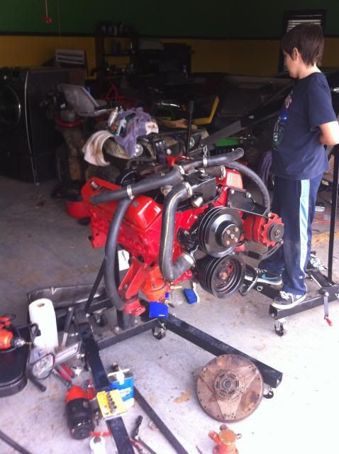

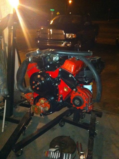

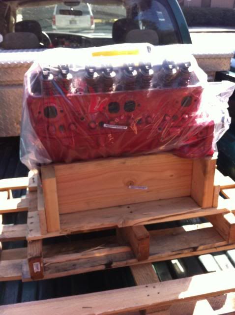

Here are some pics of the new long block...
The valve covers didn't get painted but I can live with it. I still haven't had a chance to bump the motor over with starter. The stand I have won't allow the flywheel to fit. I'm going to hang it from the hoist and install the flywheel, then lower it down onto some wood blocks and crank it over to confirm TDC and mark off the balancer. Do they make a sticker or something I could place on the balancer for timing marks?

Engine looks great, I like the red/black combo. No wonder is looks good, the supervisor in your pic looks like a stickler for detail.:)
Keep up the good work!
