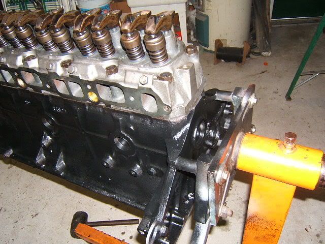

Fishermark
Oct 19, 2003
5,627
Re: 1985 Mercruiser 140 Won't Start or Manually Turn.
You will need to remove the bellhousing at the back of the engine and the flywheel. Then you can bolt it to the engine stand. Like this:

Ok, thanks, How'd you get the head that clean? My head has a lot of rust on it and I would like to clean all parts of this engine, before I rebuild it, without having to pay a shop to clean it for me. And do you have an exact bolt size to mount the engine? Or should I compare them to the ones I remove?

That head has been rebuilt, that's why it looks all shiny and clean. If you are going to completely rebuilding the short block (sounds like you might be there with it locked up) I would just plan on rebuilding the head, after 25 years it's probably due... For cleaning the parts, leave it to the shop. Most likely they will insist on cleaning everything, anyway.
The engine stand bolts are 3/8", something like 3.5 - 4" long, depends on your engine stand. I'd want 3/4" of bolt thread going into the block, use some washers to shim the bolts out like Fishermark did, I did the same.
