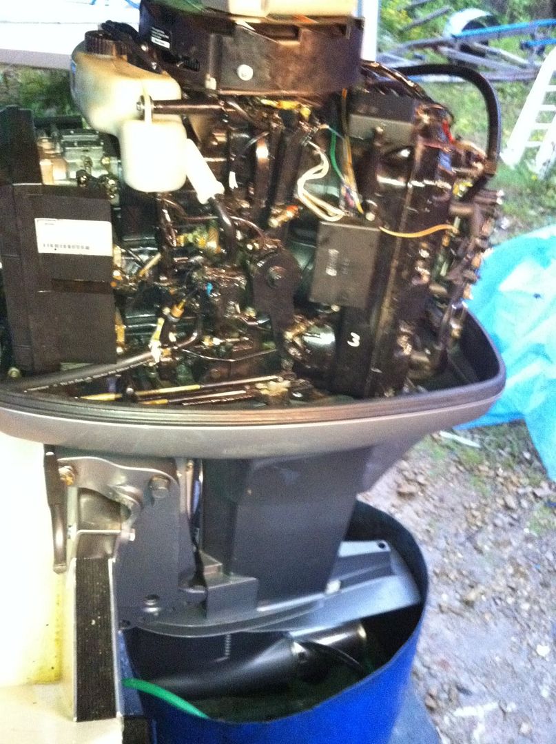

Got the engine sorted today. It was reading 130-133 psi across all six cylinders :D

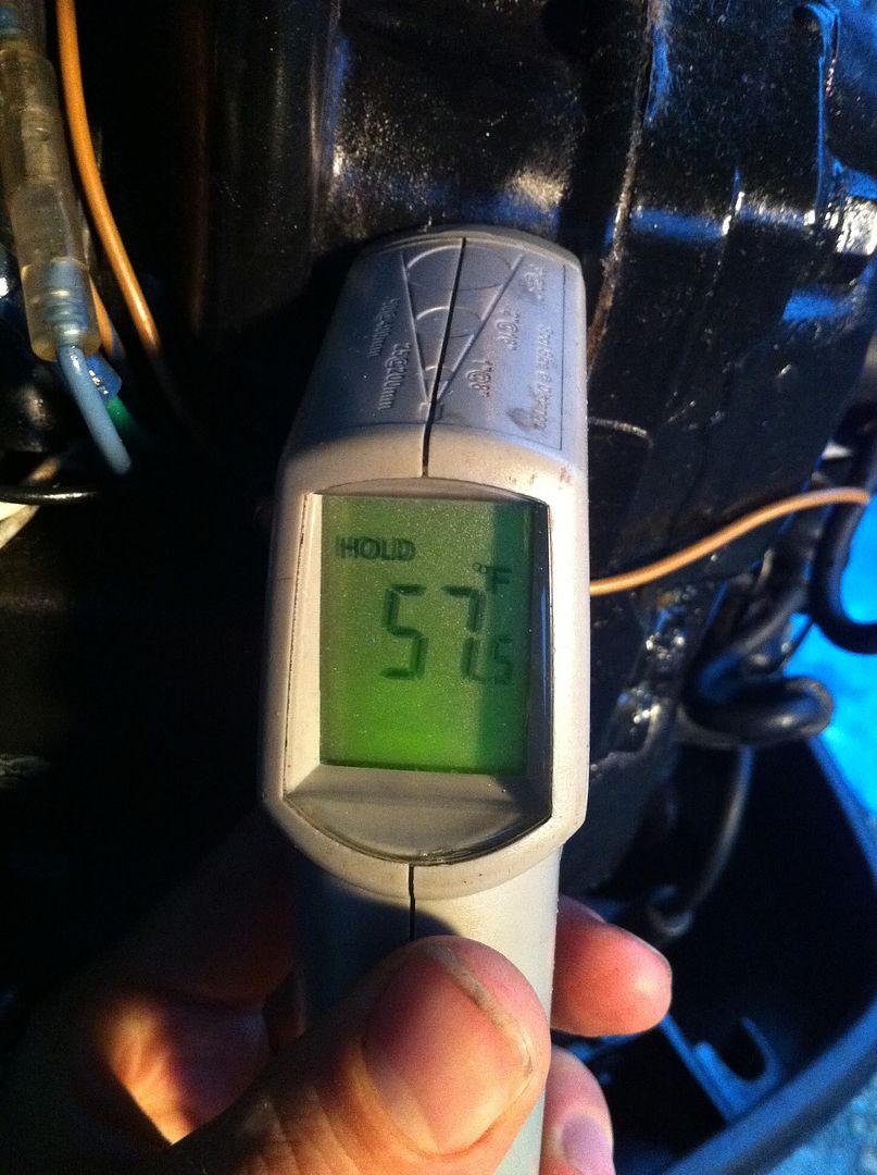

Put the new thermostats in last night after tapping out the threads and cleaning up the bolts. Ran it up in a tank and it worked like a charm!
I also used a temp gun I to make sure the heads weren't getting too hot. This shows temps before starting:
Went up to about 120-140*f at idle in the tank after about 10 mins. Tell tale was showing water within about 10 sec, then at full flow when the thermostats opened after about 2-3 mins.

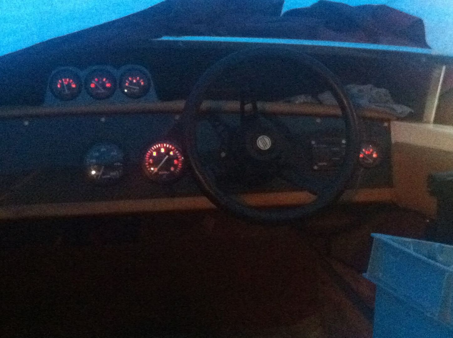

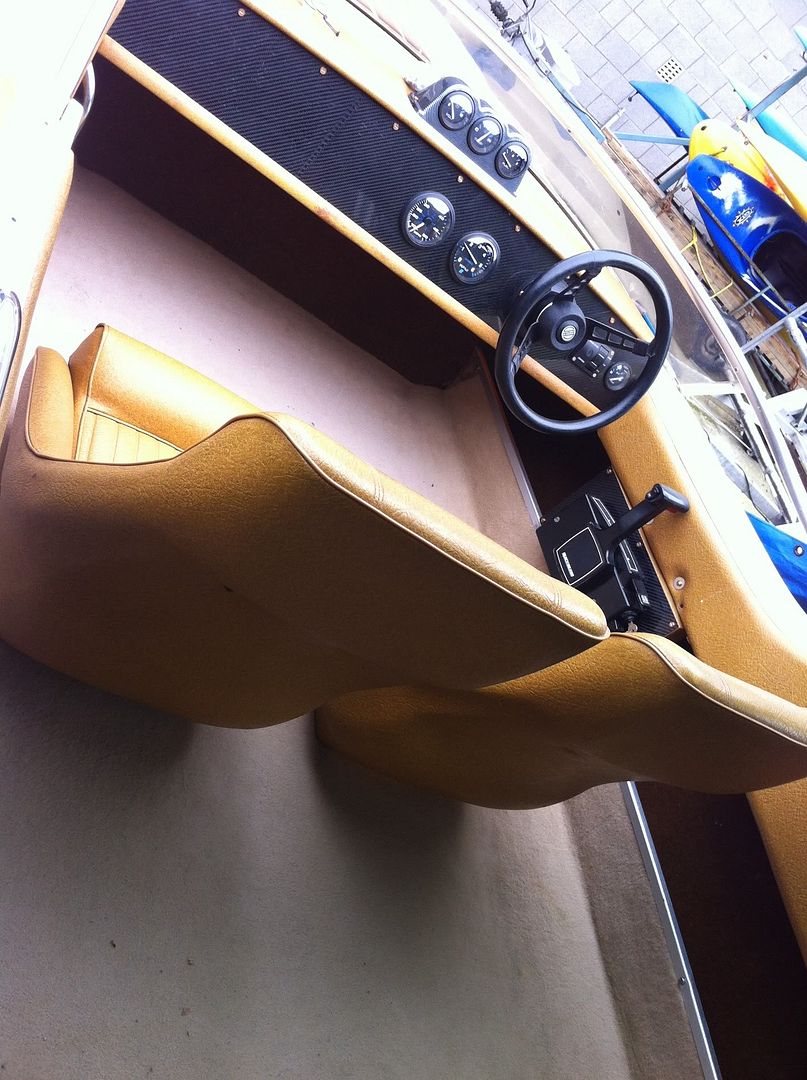

Quick pic of the dash illuminated last night before I left the marina at about 10:30pm! Still need to order a bulb for the speedo. PC161 bulbs are night-on impossible to get in the UK! Looks like I'm gonna have to order one from eBay US.
Got the carpet in today, which let me put some trim and the seats in! Woo! Starting to look like a boat now:

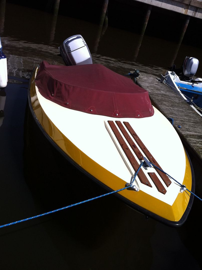

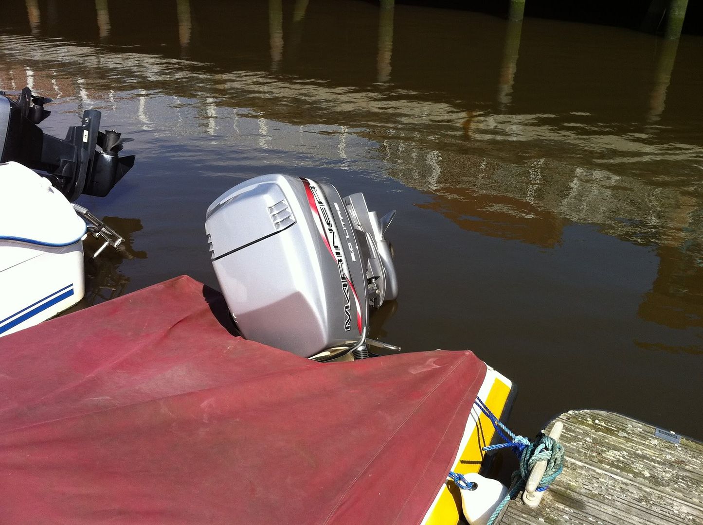

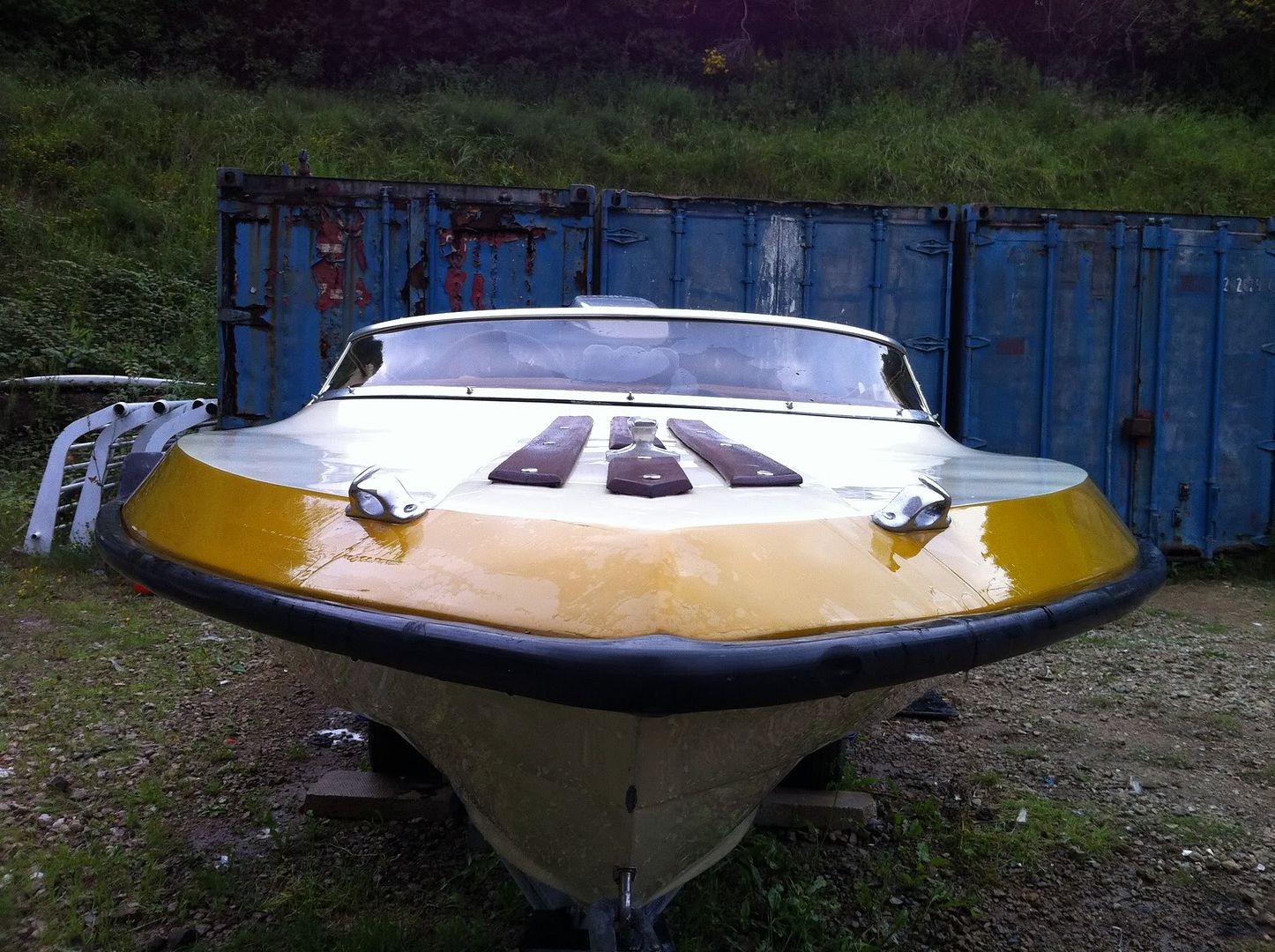

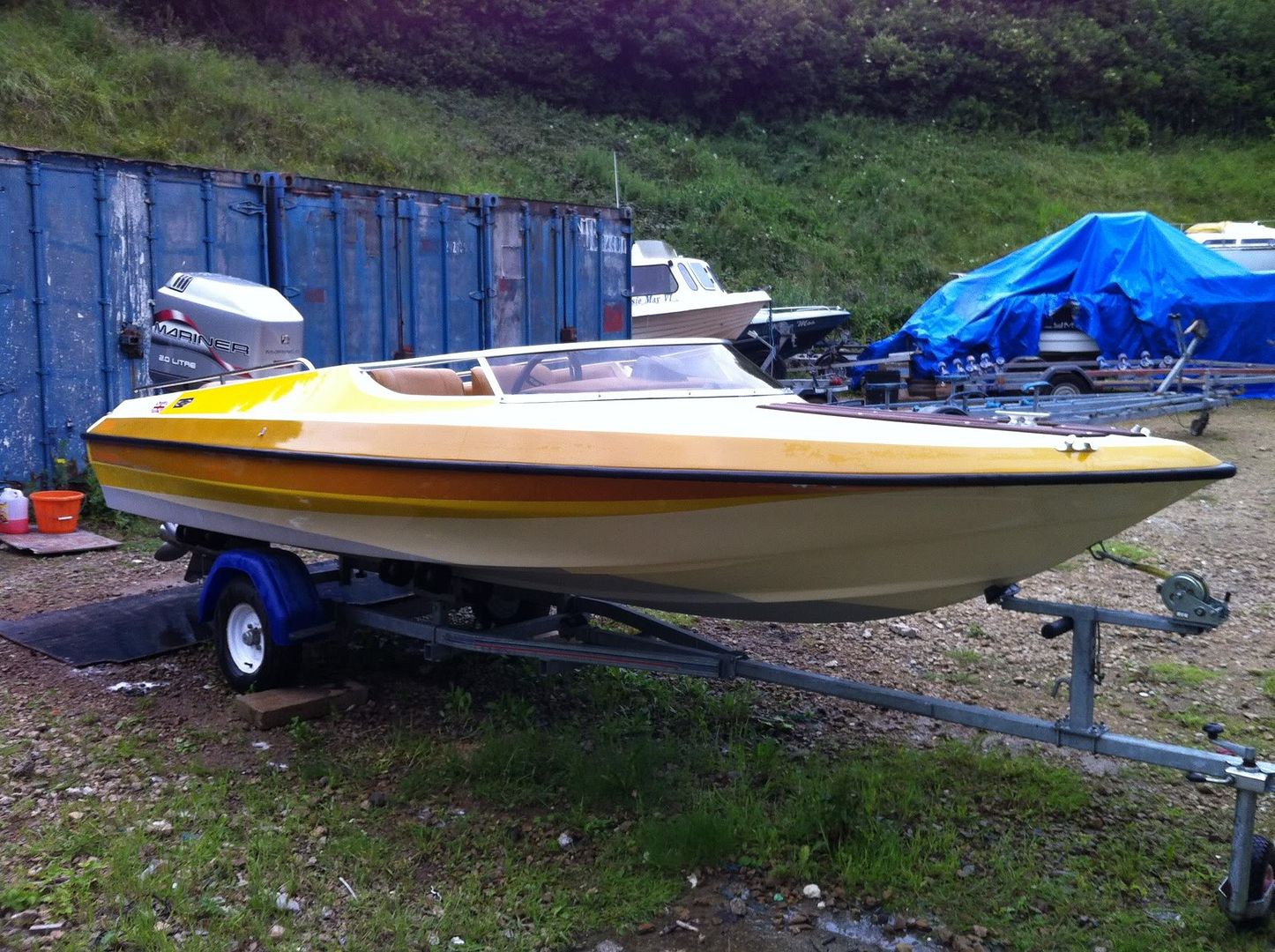

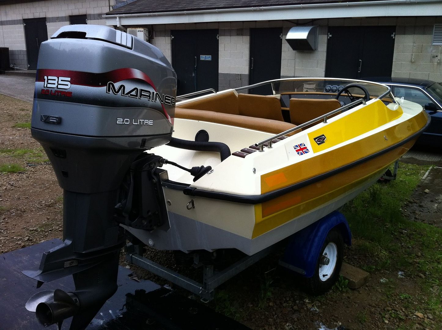

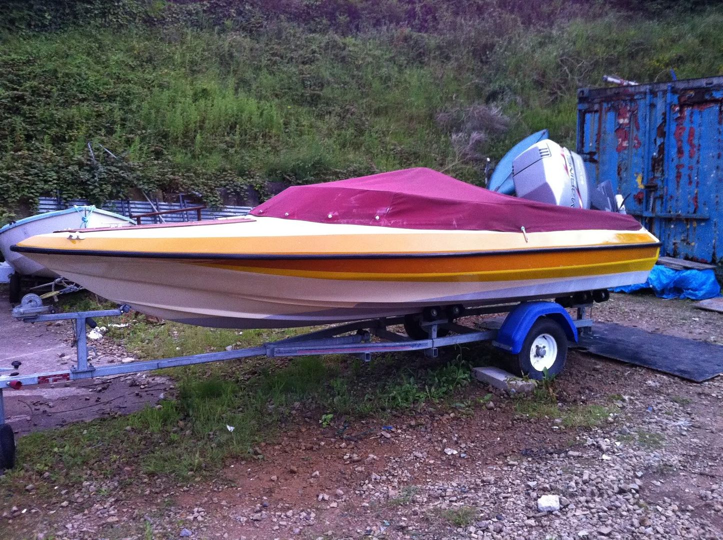

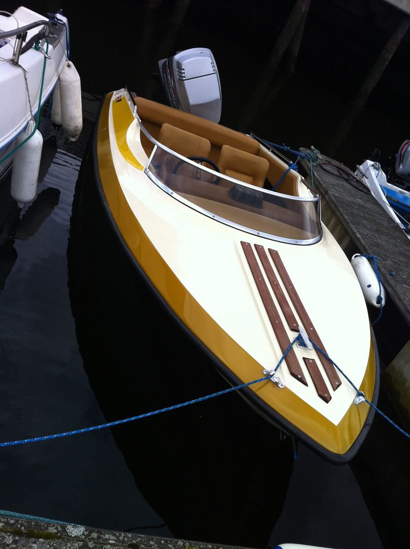

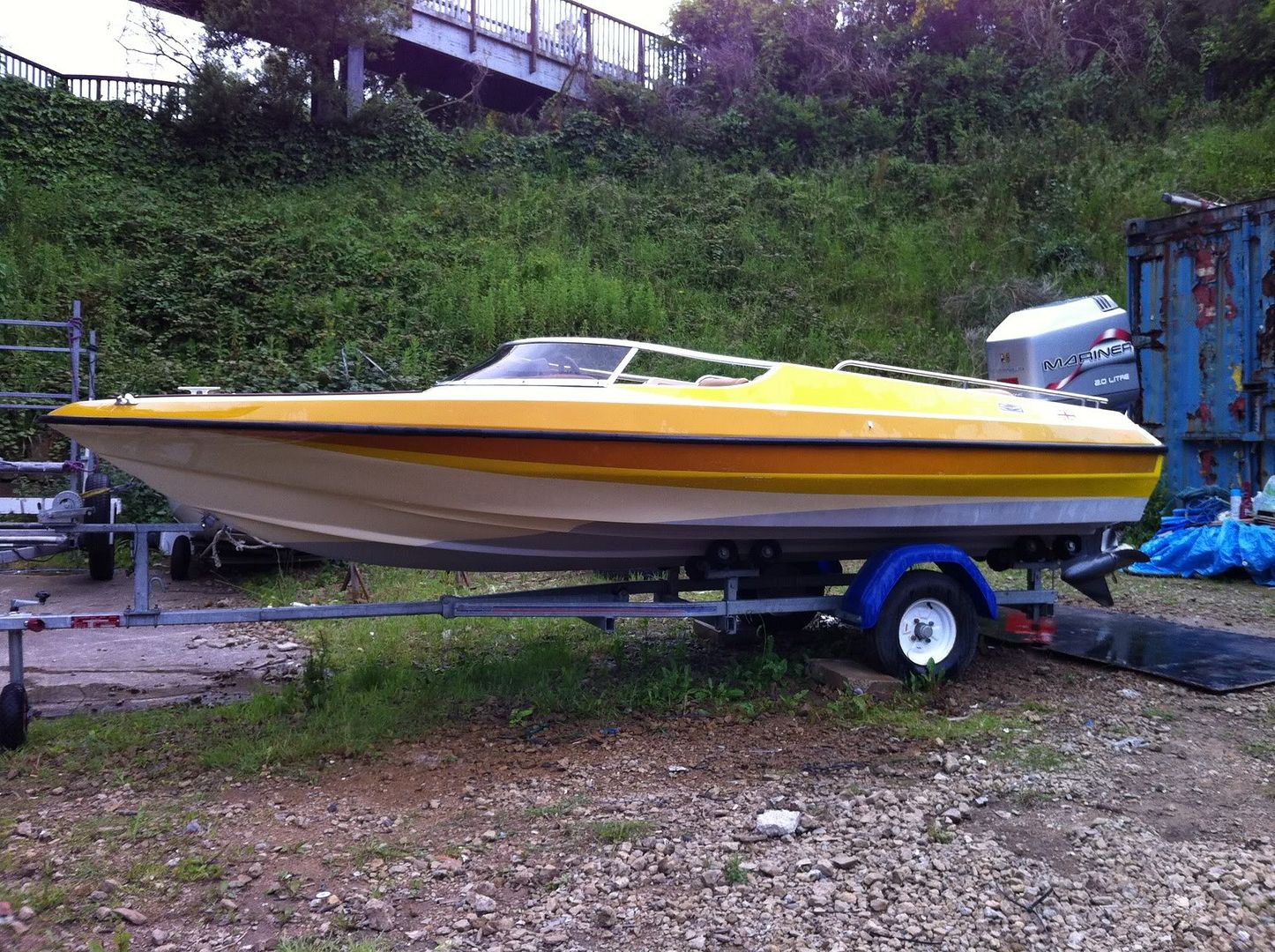

BIG NEWS!!!! Bumblebee is ready for getting splashed in the morning!! I took these last pictures before this Autobot heads into the water!
kwik_uk
May 25, 2011
155
Re: 1986 16.5' Dateline Bikini full gut and rebuild. My first :D

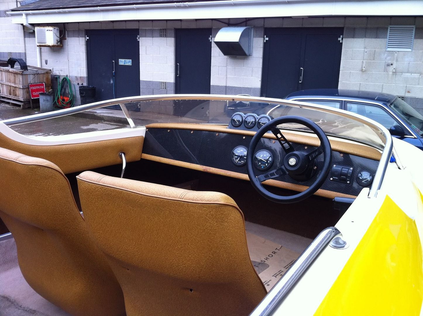

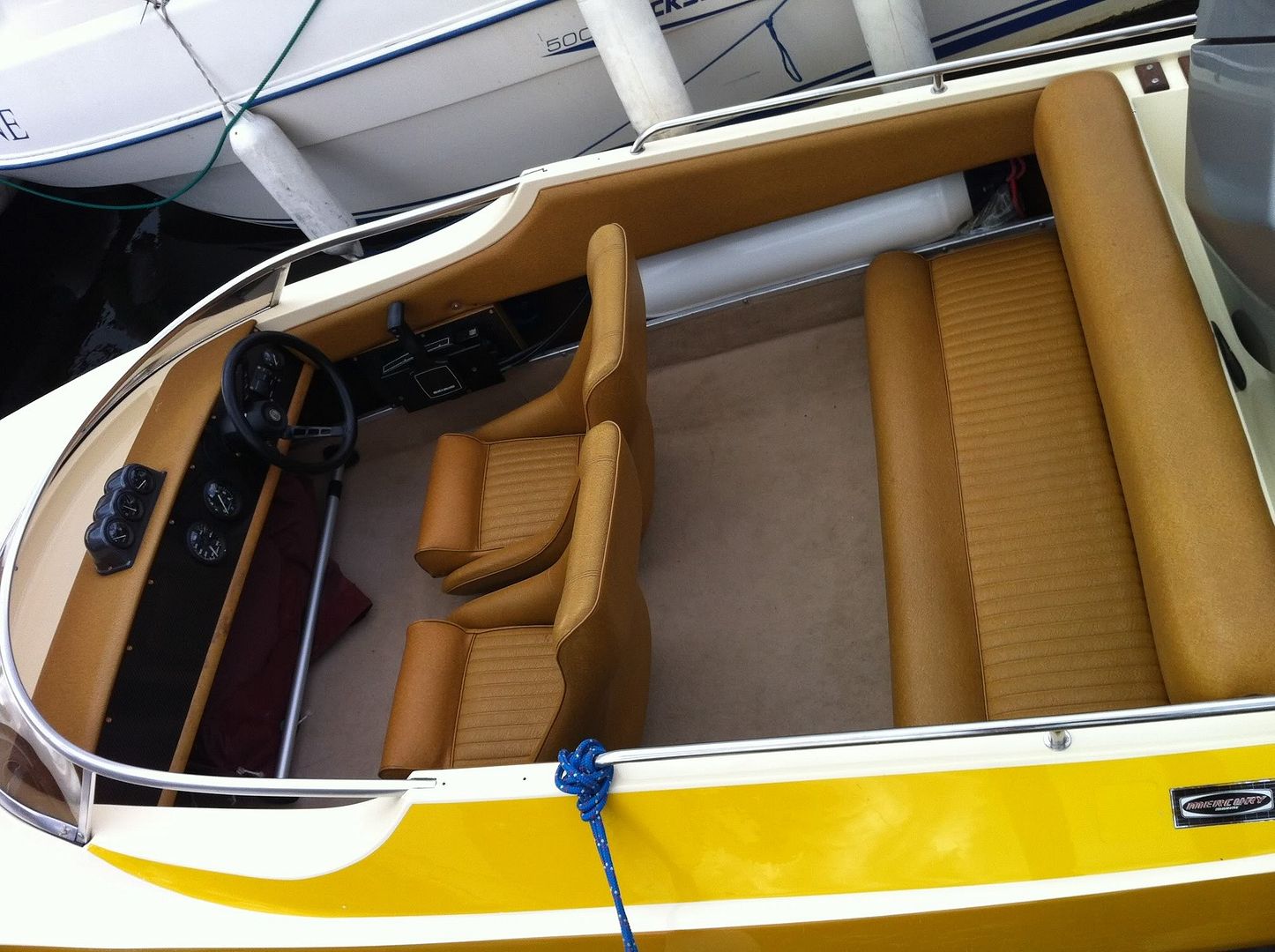

Some interior shots:
I am so excited I doubt I'm going to get any sleep at all tonight!!
I'll be sure to report back tomorrow with plenty of pictures :D

Re: "1986 16.5' Dateline/Sidewinder sports boat. Full strip and rebuild
Awesome good news on the upcoming water christening!
Bumblebee looks Spectacular!
To say that I am a wee bit envious is an absolute understatement!
I too, drool at the sound of a healthy engine...
Safe Journey, Have Fun, and Godspeed!
Oh yeah, don't forget the bilge plug...:rolleyes:
If possible, pics, or better yet, video would be most appreciated...ahhh, but to live vicariously through the wonderful accomplishments of successful Iboaters...
Let Autobot Bumblebee be a long time provider Fantastic times!
:D:D:D:D:D!!!!!!!!

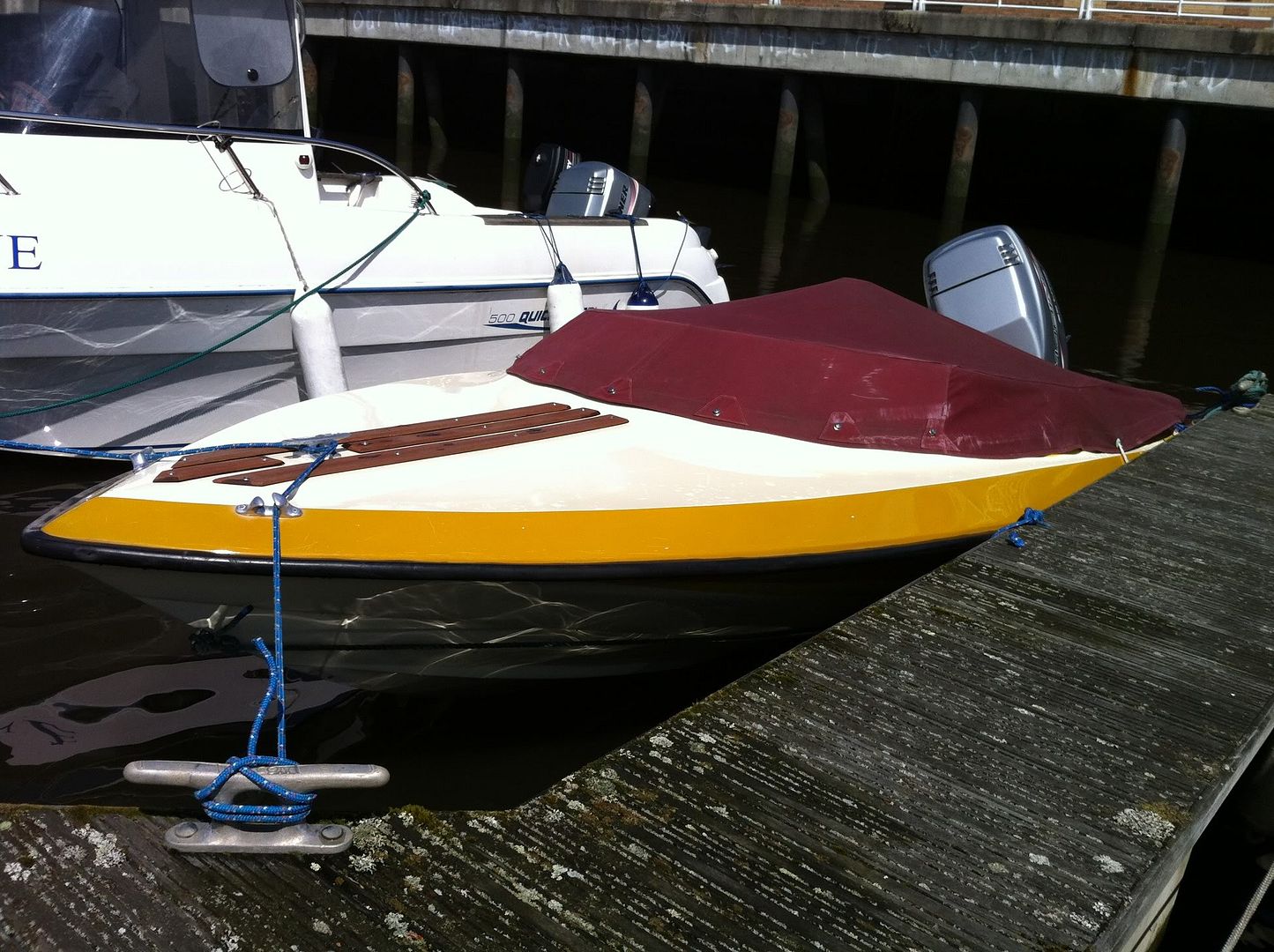

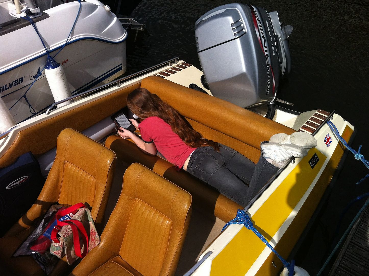

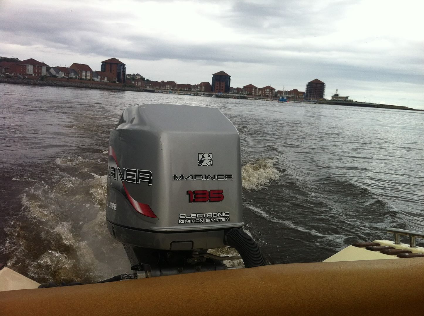

and one of Kate enjoying the fist glimpse of sun we've had this summer!!
All in all it has gone pretty well. The power is PHENOMENAL!! Instant acceleration. There is almost no time between dropping the throttle and it being on the plane. Can't believe the difference this has made. Did a rolling start from idle in forwards, with a full tank of fuel, two grown guys and a box of tools.... went off the clock in about 5secs!! It's a 50mph quicksilver clock, and I'm going to have to consider getting a bigger one. We must have been hitting about 60kts easy. Was quite scary!
Needed to put three bags of sand up front in the bow to even the weight out. This made a big difference to how it handles at low-medium speeds. It also looks much flatter in the water.
Only thing I've noticed is my temperature gauge is reading hot after a short while. Water is being pumped, tell tale is operating etc it's just registering as high on the gauge. I've just replaced the sender with a second hand one and I'm not sure whether these should be paired like some auto solutions? I'll post this question in the outboards section, but if anyone has any ideas I'm open to suggestion.
All I can say is I'm one very happy man right now!! Woo!! Still got a lot more to do though, so watch this space :)
