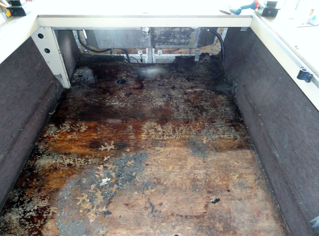

Welcome aboard Lago! I have the same boat and gutted mine and replaced the floor and transom. It does look to be the original as it is in 3 peices. Pretty sure the poured in foam is soaked. Get that weight out of there and your boat will perform way better (200-300lbs less dead weight!). Your gas tank should be 17 gallons. Mine started to leak and I replaced it with a plastic one with same dimensions. The pedestal seats are add ons and not original. The gut and rebuild can be done but it is time consuming. Another required tool will be an air rivet gun for the pop rivets. And there are alot of them. I have a ton of pictures and yes you will remove the center console. I filled mine with 120 $1 swim noodles for floatation. Still my weekly fishing boat and now I started on another project boat. Going slowly as fishing time is here but I hope to splash my new to me boat before the end of the season. Good luck!
rtek816
Petty Officer 3rd Class
Jul 4, 2009
92
Here are some more ideas of what you have ahead of you! Fun, fun, and more fun.....

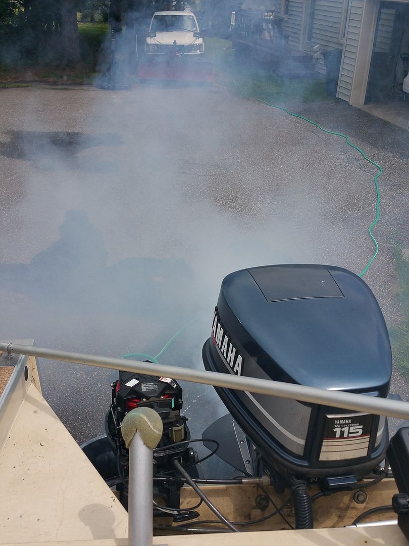

Holy Hannah that's a lot of foam. Can you hack it out or is there "stuff" stuck inside it like wiring/plumbing? I will definitely have questions for you when I start the rehab. Today I mounted my 9.9, hooked up the control cables, and started her up in a garbage can. I was also able to perform the jump on the lower unit test, and am glad to report that it was rock solid. No flex in the transom or movement in the gaps. I also started her up...after I dropped $100 on a new battery. I guess that really WAS fogging oil {rimshot} :lol:
GA_Boater
May 24, 2011
49,038
Cough, cough - Seasonal skeeter fogging begins. LOL
If you're going to run it for the season, keep a close eye on the gaps or cracking in the splashwell aluminum.

Lago, the wiring, control cables and steering run through an aluminum channel riveted to the starboard stringer and floor from the hole under the console to the hole in the transom (and through the back below the floor into the bilge area). There is no foam in there. The only foamed in tube I had was the drain tube from the livewell. Even after replacing the transom and floor and rivets those areas in the splashwell will crack over time (the caulk). If it is the original transom (and I think it is) do some core samples in the lowest corners to see the condition. A 28 year old but will most likely have rot as the original wood wasn't sealed anyway. Once you get the foam out you will be amazed at how much less draft the boat has and how much better it will perform. If your comfortable the transom is solid enough, run it for the season and fix it through the winter. If you are getting water into the splashwell while it is sitting in the water (through the drain holes) your are butt heavy or overloaded. My opinion.

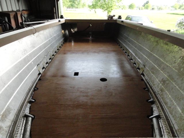

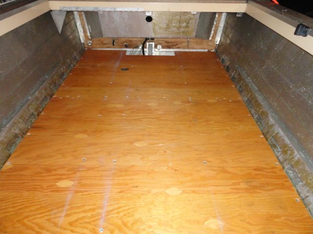

Hello Gents... It's time to install a new floor in the Mariner. I am having another person do the job as I don't have the time or skills. My question is... What did you do differently from the factory setup that you would recommend? I may replace the original gas tank and was wondering if I should locate it in the floor or in the original location? It's kinda small as is so if possible I'd like to increase capacity. That worries me in regard to additional weight in the back as it sits kinda low already with the 115 & 9.9. I would also like to make a dual battery setup as I plan to add lighting and electric downriggers. I'm thinking of cooler seats instead of pedestal for increased storage. Floor covering... Nautolex or Tuff Coat or...
Any thoughts or ideas are welcome.
Watermann
Jan 12, 2013
13,859
Adding a larger fuel tank comes with the huge issue of finding one that will fit in the space. If possible the original tank could be moved fore to more of a mid-ship arrangement. The increased length of a new fuel tank could also go forward in the boat helping out the balance.
Adding extra angle AL cross supports is a must at the joints at least and do away with the original thin deck joining strips.
Of course flotation foam, adding the closed cell rigid foam board is the best option out there in my opinion.
Nautolex vinyl deck covering is one of if not the best choice for ease of installation, durability and cost.
Candutch
May 8, 2015
637
H2O covered most of it. Make sure the plywood is at least exterior grade douglas fir or you can go with marine grade. I went to 5/8th inch thick and most do just so the consoles and windshield still line up but since you have a cc you could go 3/4 easily.
Spar varnish for sealant, at least 3 coats per side. Some use epoxy it's your choice.
I moved my original fuel tank up under the bow deck and the boat still handles perfectly fine but I did add some weight to the stern with my rear deck mod, dual batteries and 8hp kicker.
