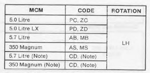

The note you asked for ^^^...
Below is the block code information in Section 3A the note is referring to.
53,272
Raw water cooled, 140. Fresh water cooled 160. Raw water cooled and efi 160, fresh water cooled and efi 180
