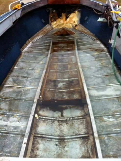

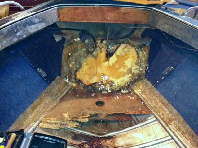

I did eventually get the tank out with a lot of prying and breaking the seal of the foam. I opted to leave the fuel in while prying so the tank had some pressure/weight to "push" back. I was worried that force needed to pry it out would stress or flex the tank too much. Once the tank was mostly loose I took out the fuel to make it easier to manage.
Here's the odd thing: the tank itself was actually sitting on a 1" bed of foam between it and the floor. The way the upper brackets are attached to the hull, the tank could actually use another 1/2" in height. Not really sure if it was intentional or if the foam got in there by accident and then expanded and raised the empty tank with it and then the mounting brackets were added afterwards. I'm sure I'll be scratching my head when it comes time to re-install it.
When it does come time to put it back in, (& I really liked how well that foam held the tank) what type foam (out of a can) should be used? Should I leave some of the current foam in place as a "form" to get the proper placement/bonding later? If I remove the old foam completely, will the new foam adhere to the hull as well as what is here currently?

You'd use pourable expanding foam from someplace like U.S. Composites. Avoid the temptation to use Great Stuff :)
Bah, I thought my subliminal thoughts in the parentheses would get me an easier solution. I can add that to my epoxy order.

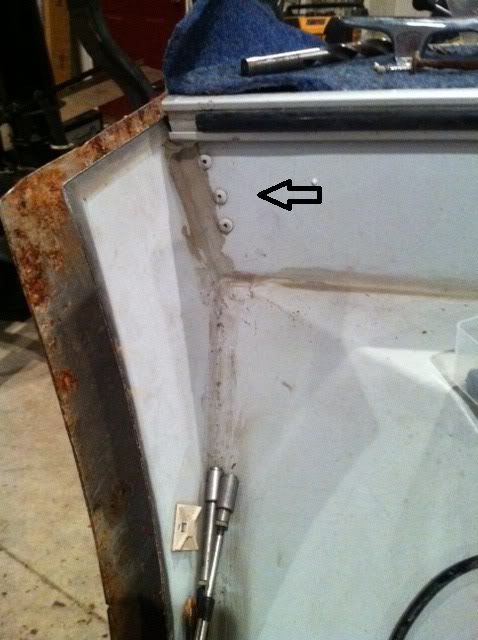

I disconnected a couple hundred wires and cables and lifted the motor off to start on the transom. The plans from the link I posted work great (with some modifications for a larger motor) for the outboard stand
I also gave the inside a good spray down and did a quick leak test
I was pretty pleased to only find a really slow leak (one drop every few minutes) from two rivets on the port bow and a slow leak from a poorly mounted transducer bracket.

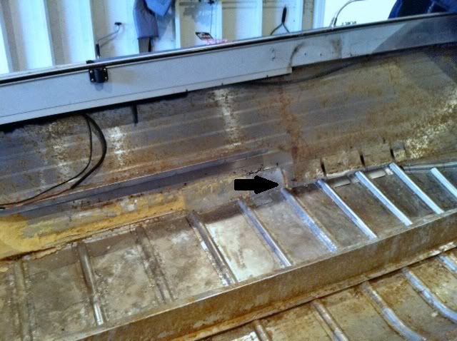

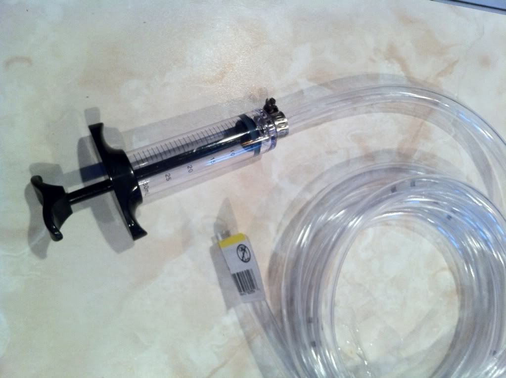

A quick question:
I know some you Starcraft guys have run into this issue but what is the best way to apply Gluvit to the area behind the hull/side brackets?
Pictured here:
My guess is this (obviously w/the hose cut shorter):
Any other ideas/tips?
Also, is acetone a good option for a final scrub and wash before gluvit? I've power washed most of the grime now it's on to the removal of the harder gunk.
ezmobee

Re: 1987 Bluefin Sportsman 1900 remodel
I just didn't. Ya do what ya can do.

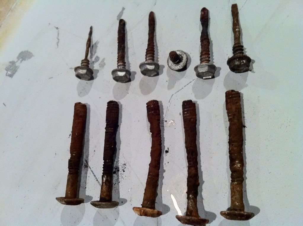

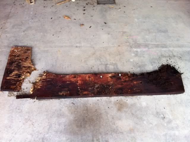

I removed all of the transom bolts and screws. I love all the mysterious paper (aluminum) cuts that appeared after that job.
I was also surprised by the level of corrosion on the hardware. Many were completely corroded . This boat really was held together by globs of silicone.

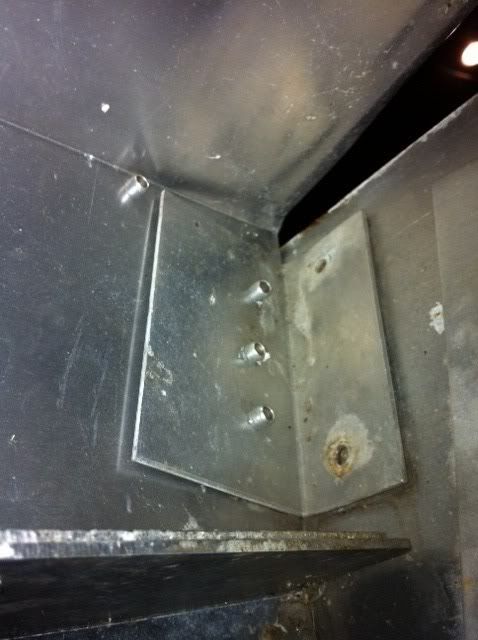

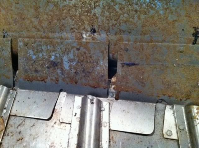

The most difficult part of removing the transom was unscrewing this gunnel mounting plate:
I am thinking of mounting that bracket on the exterior side (swapping the two sides for proper angles) for ease of use. Removing the screws was one thing, drilling and installing them back will be another. Do any of you have any experience with this hard to reach bracket?
Unfortunately I was not able to get the transom out in one piece but after some MacGyvering I was able to get close. Definitely enough to rough out some easy templates.

This was my favorite tool of choice for removing the transom:
My transom removal recipe: A lag screwed in at varying angles with a heavy gauge wire loop attached to my hoist. I had a couple of cats claws to hold each side up while re-positioning the lag and a rubber mallet to jar the transom loose if it got stuck. Slow and easy but it got the job done.

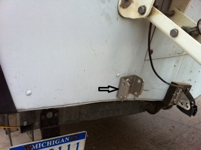

Does anyone have any similar experience with/or see a problem with moving this bracket to the outside instead of inside the gunnel?
Structurally it would appear to be no different.
jigngrub
Mar 19, 2011
8,155
No structural difference, just a cleaner look on the inside... but it's your boat and you can rebuild it any way you want! That is one of the best things about doing your own resto, you get to do it the way you want.
