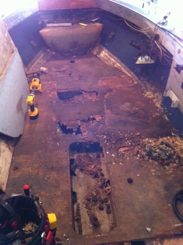

The original floor is shot. The po replaced the rear third of the floor but that will have to come out since the rest is totally rotten.

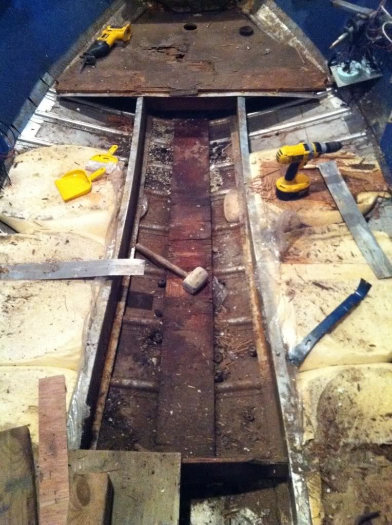

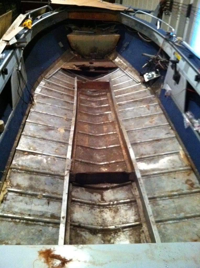

And the work begins:
Here's a shot of the floor:

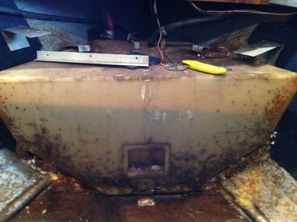

And the bow tank:
BTW, you guys make this look way easier than it is. Lots of little questions as I was removing this or that that resulted in some iboats searches. Some of the things, like a tricky steering wheel removal, I tackled and accomplished. Other things, like the fuel tank, at this point, I'm throwing in the towel and will work around.
Before I totally remove the floor (it's not coming out in complete pieces) I am making templates using cardboard. Once that comes out, the list of questions will begin...

I like your project. Aside from the floor it seems to be in decent shape. Then again, pictures always have a way of making things look better. You are going to have a good time with it. It will consume you.
I can't help you with the gas tank, mines mounted on deck under splashwell. Running wires was fun. I should have taken the side panel back off to do that.
Keep on asking, You will get your answers. Keep the updates with pics comming.

that is one heck of a tank !
welcome to iboats !
the tank should have a flange on it.....this flange is screwed to wood in the floor.
it also looks like they have shot foam in between the tank and the hull.....if the flange is removed....its just the foam holding it in.
the foam is a pretty good glue.....it will take some doing to get it out.

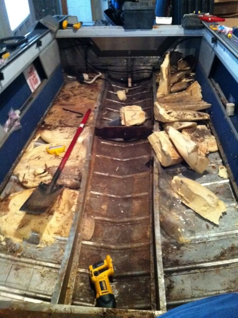

Thanks guys.
I took the front flange off of the tank and put 200lbs of gristle into it and couldn't get it to budge.
The tags on the tank aren't legible but from what I can figure (it's an odd shape so I didn't go the calculator route), it's a 19 or 20 gallon. The po made a very ambitious last fill up- there has to be atleast 15 gallons of 2 year old mixed gas in there. Anyone have any suggestions on where to properly dispose of the gas?

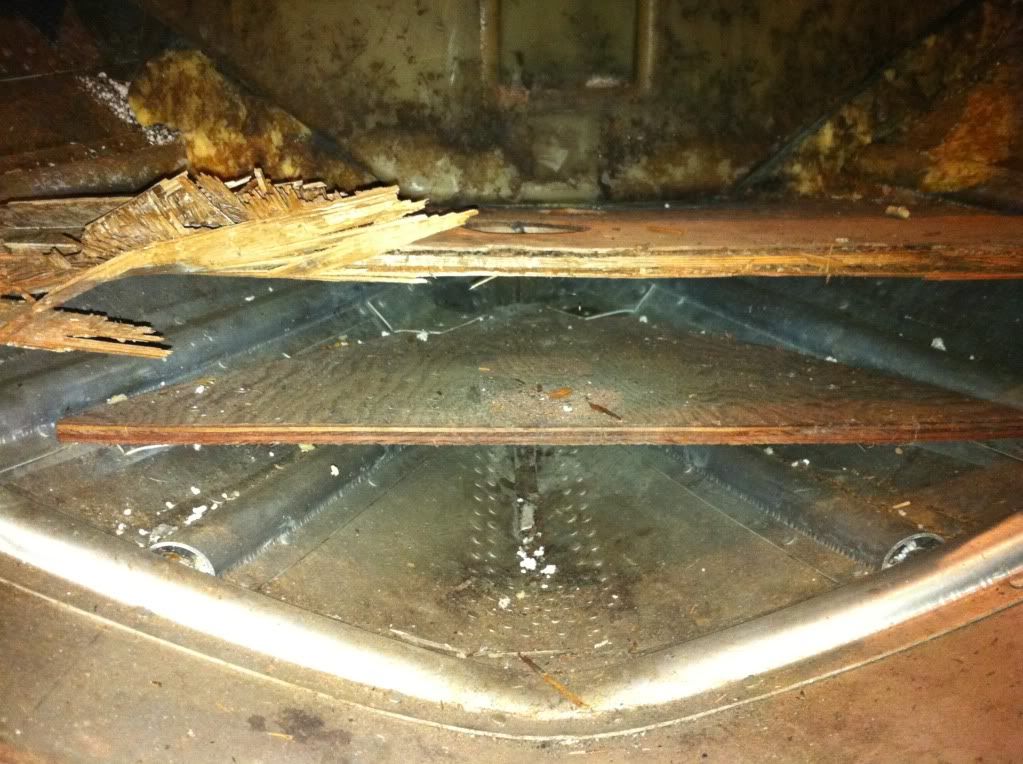

Made some progress on the templates and foam. I would have been chipping away for hours to get all the foam out but pulled out a digging spade and had the foam out in 15 minutes in nice, big, easy to clean up pieces.

Man,you lucked out! Most here spend a good portion of a day (or longer) pulling it out in little chunks.
If the PO replaced just the back 1/3 of floor, I'd bet it had a belly tank instead of that out of place bow tank. Depending on the condition of the fuel lines. I might consider putting it back, depending on weight distribution. But I don't know Tinny's at all, nor Bluefin boats.
That deck under the tank looks like it's shot too, tank may need to be removed to get that deck out & new back in place.
A good scrubbing & some Gluvit & you'll be about ready to re-deck this baby!
Good luck, good looking boat!

I'll no doubt get hammered for this, but I would burn that gas in 5 gallon batches in my work truck. Check it to see that it is not all full of water or smells like old varnish, but if it looks and smells like gas I would use it. Your truck will never know the oil is in the fuel, I burn off all my boat gas in the car or truck at the end of each season. 5 gallons of the mix and 5 fresh will run like a charm.
I think that tank was made for that boat and that position and I'd probably put it right back there. I do think it will have to come out to fix what's under it.
My floor looked like yours, I wish I would have thought to make templates before hand, it would have saved me a lot of time later.
Good progress, keep it up.

On your fuel tank, I'd try to siphon the fuel out to make it easier to wrestle out of there.
Old fuel around my place usually helps get a bon fire started:D
I think that tank is a great fit for your rig, I'd definitely put it back in there.

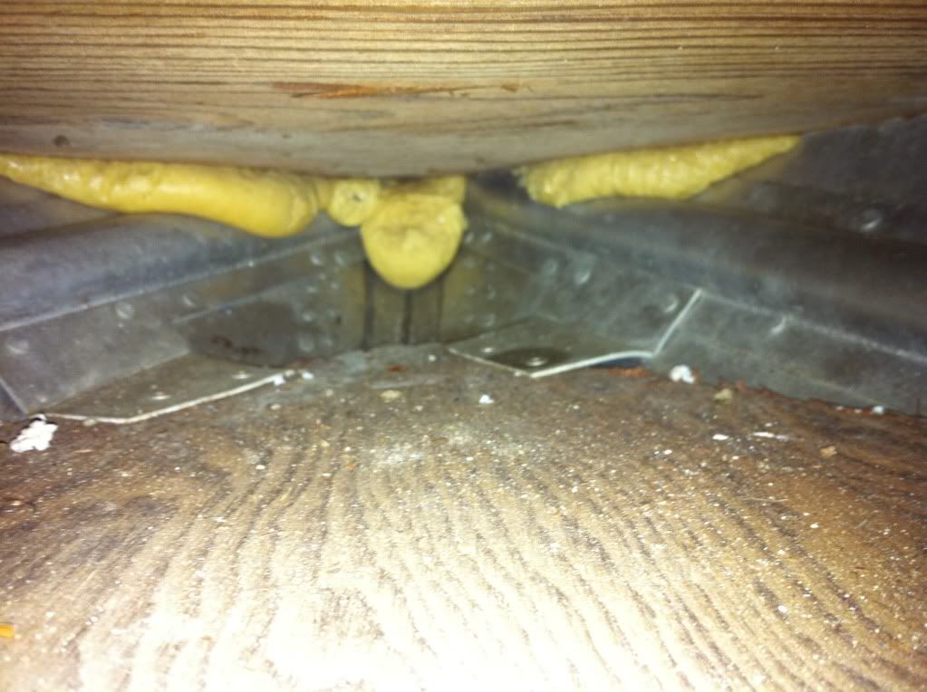

Here are a couple more shots under the tank area:
The wood in this area seems to be in good condition when poking and prodding with a screwdriver & cat's claw. I guess that makes sense since this area is mostly covered, protected, and not exposed to the elements. I was not expecting the extra piece under the floor.
Here's my dilemma/question:
The tank is very well secured (by the foam) in the bow at this point and I question whether I will be able to put it back in the same secure way. I am planning on replacing the entire fuel line but the fill line will have to be cut (it is hardened with two bends and stamped with a Coast Guard approval rating) and replaced. I'm not sure where (or if it's even necessary) to find the CG approved replacement. I'm also assuming the replacement would be more flexible than the existing one (I hope).
If I were to apply epoxy to the existing wood (both pieces)in place, would this be ok? Or, if I take the tank out, what would be the best way to get such a secure fit? A can of spray foam? Or, another option: take out the tank, leave the foam in-place and adhere it back (with)?

Kinda hard for me to see how that tank is in there but for my piece of mind I'd want it out, rebuild everything, seal up new wood with epoxy, reinstall tank.:)
I think the main issue holding the tank is the foam. The upper two brackets holding the tank from above are not exactly tight.
I'm going to do some prying & grunting and give her another try.
