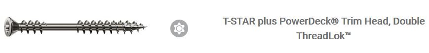

For the floor install, I made cleats and supports from mahogany which were then attached and bonded (with Seal Bond 105 and Spax stainless steel deck screws) to the stringer sides to protect the integrity of the glass-capped stringers. After that was done I used more Seal Bond 105 on the tops of all stringers and cleats before laying the floor boards down and securing them to the cleats with Spax Stainless Steel deck screws.
