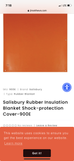

Definitely a night and day difference. If you have room, suggest some kind of rubber cushioning to keep the tank from rubbing a hole where it contacts the aluminum you are adding.
SHSU
87Starcraft
Sep 15, 2021
135
SHSU
I have a couple of old rubber blankets from work I’m going to put down. Free rubber, free aluminum, about $2.00 in rivets. 👍
