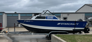

Hello, My name is Shane and I am in Austin tx. I recently bought a 1987 Starcraft islander 190v with a Johnson 110 outboard. Seems like a rare boat from all 222 posts about Starcraft I read here.

Indeed, very much a unicorn. Most Islanders and Chieftan's are I/O, but the outboard boats are very sought after
