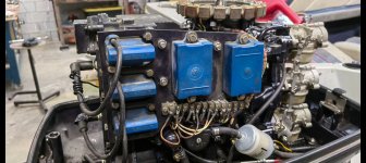

I finally got back to working on this rebuild after many life stressing events. I now have the motor all put back together except for the electrical hook ups, throttle linkage and flywheel. I broke a small piece off the flywheel when I was pulling it. Like the lame brain I can be sometimes, I first tried pulling it with my biggest 3 jaw puller, which caused the break. Then I got smart and made a puller like I should have to begin with and pulled it in the manner the service manual shows.
Anyway, a few days ago I went back to view all the pictures I took of the motor before I started the teardown and during the process. Much to my dismay I could only find several pics I took of the electrical wiring, and I seem to be missing some of them as well.
Now I'm hoping I can get a fellow forum member who may have a similar motor to take a few pictures from different angles of both left and right side of the motor, including throttle linkage and mechanisms. This would help me tremendously in the final chapter of this rebuild. I can almost feel me lowering the motor down onto the lower end and bolting it up.

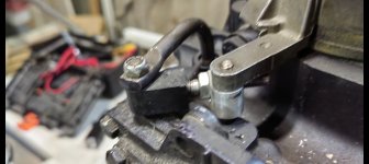

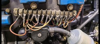

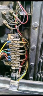

Here's another stumbling block of mine. All of the wires except for one out of each of the two C-D units were never disconnected when I tore down the motor. The one wire I had to disconnect I cannot find where it goes. One unit the wire is black with a yellow stripe and the other unit the wire is white. Both of these wires are coming out of the same spot on each of the C-D units. The service manual says the white wire goes to the terminal block. Can I safely assume that the black with yellow stripe goes to the same spot on the terminal block? Please see pics I provided. Thank you.

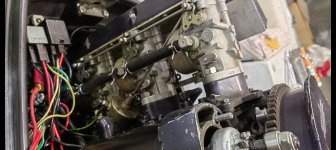

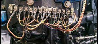

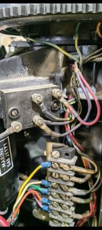

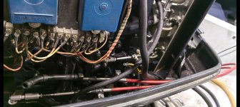

I have a few pictures of mine a 1989 85hp, maybe they can help you.
I thank you very kindly. These might help me some with the electrical hook ups. I really appreciate it. I have been surfing the web and looking at every picture I can find. A couple of which helped me with some of the linkage. I don't have too much more to go before I can finally get this beast off my work bench and lowered back down onto the lower end or motor leg, whatever it's called. This being the first outboard motor I've ever owned and worked on, I am very unfamiliar with the terminology.
