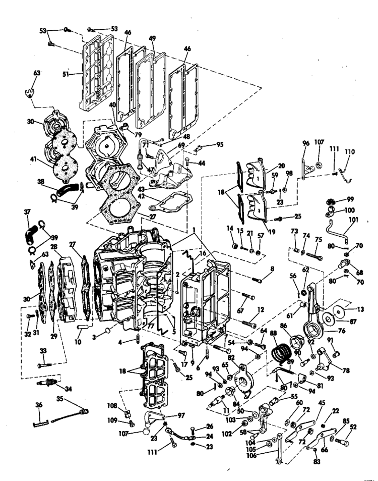

Seems like part # 69 is a lift ring:
#69 — 318485 — 318485 — LIFT BRKT., CYLINDER (1 required per assembly)
0318485
0318485 - Vintage, BRACKET
Replaces OEM # 0318485
$6.00$6.00
4 in stock.
From here ;)

That would be it. It should be right next to the flywheel. I'm not sure if all motors had them though????
