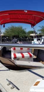

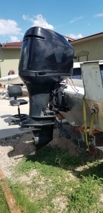

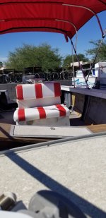

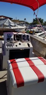

Some other stuff done..cushions are done...console refurb mocked up...bimini installed...hydraulic lines and control cables run...batteries moved to front of helm seat...Optimax 200 mounted... more to come
