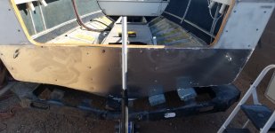

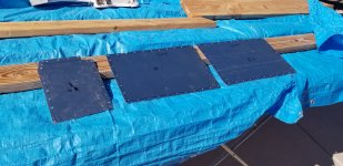

New transom is in...transom has been reskinned and patch panels for the hull...rivets on Tuesday!!

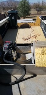

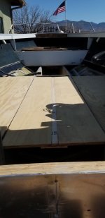

Working on the new deck and foam...delayed by high winds almost daily...and a few dust devils thrown in for good measure...yay!

Extruded...not expanded...polystyrene..1" thick..on edge...rigid, closed cell..waterproof..lengthwise..on top of the cross ribs
dizzyspots
Petty Officer 3rd Class
Sep 21, 2007
87
Fyi...what you see is one 4x8 sheet of 1" board...guess it's going to take 3 or 4 total...stay tuned!!
