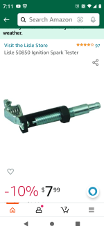

39,901
Does spark jump a gap of at least 3/8" or more , yes or no ?-----You have checked flywheel key ?
