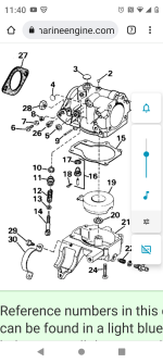

There is a high speed jet ( orifice ) in the very bottom of the float bowl.----Is it the correct size and clean ??----Is the nozzle gasket in place ??
saltchuckmatt
Jul 19, 2019
3,332
Which would be part number 20 and 22.
Also I can't tell, is part number 1 in?
