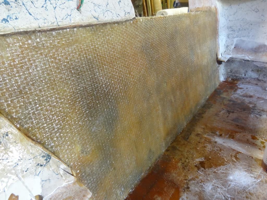

I used approx 3 quarts. + or - - There was adequate squeeze out along the top, bottom and port sides and a little less than I wanted on the lower starboard side. At the time the picture was taken I had already run a spoon over it. Before that - there was still some built up. I didn't have to waste any though. I was really trying to cut it as close as I could. I just didn't see much point in having tons and tons come out - only to be discarded or have to be sanded off. I'm going to back fill (inject) the small portion of the lower starboard side with some PB and then filet the whole thing officially. Then it's getting glassed to the hull Completely and finished with gel coat.. Even below deck - as that was the way it was before.
Woodonglass
Dec 29, 2009
25,932
Sounds like a Plan!!! 3 qts is just about standard for transoms of this size. NICE WORK!!! Looking forward to seeing the Fillets and tabbing.:peace:

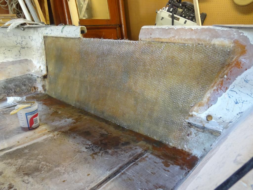

Below is a more in depth description of my process for replacing the transom.
After removing the transom I was left with the very thin and considerably damaged outer skin of the hull:
I sanded it down to reveal all of the drill holes and a few areas where I unintentionally cut through the hull while removing the transom:
I applied a thin coat of Merton's Hull and Deck Putty to smooth it out and fill the holes and gaps. I extended that putty down to the hull bottom where it meets the transom as there were some drill holes right on the edge:
Then came a layer of 38ox stitch-mat to reinforce the outer skin of the transom and plug the holes and gaps:
And a layer of 6oz E-Cloth to tab the transom skin to the hull:
All of this was done after making sure the stern was level to remove any flex from the rear:
Then I started to fabricate the transom:
After pre-coating the "B" side of the boards and allowing the resin to kick - I added a layer of 38oz stitch-mat and a layer of CSM to one side of the laminate:
Then I added another layer of CSM to the other panel and placed the two panels together:
I only applied enough pressure to get the resin to ooze. I didn't want to squeeze it all out.
About half way through I flipped it over to allow gravity to do some work:
After the resin had set I took my angle grinder and cut off the excess fiberglass from in between the laminate:
And then checked it against a straight edge prior to moving forward. If it were too far off - or had twisted during the setup I would have had to start over:
Then I pre-coated it with resin and allowed it to kick again:
After which I applied a layer of CSM followed by a layer of 1708:
After it set I cut off the excess glass again:
Then for a test fit:
Then I pre-fit my vices and rehearsed my process for mounting the transom:
Then I went ahead and applied the PB and set the transom in place for good:
After letting it sit overnight I removed the vices and now I'm ready to move on with more filleting and glassing the transom to the hull:
Hopefully this will someday help another noob get the job done with confidence... :)
