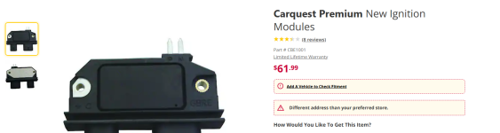

Replaced Ignition Module
1784775960785.pngUnplugged RPM guage
