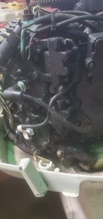

Hey guys I have a 1997 Johnson 90 I just acquired. Great compression, 135 on 3 cylinders, 140 on the 4th. I pulled the carbs and cleaned them, drained all fuel from tank, replaced all fuel lines and filters and flushed fuel lines going to carb before putting them back on. Long story short, everytime I put the hood on or take it off it catches at least on spark plug wire and pulls it out of the boot. So, when I 1st attempted to crank her, she fired up but even at full throttle had no power. Discovered one spark plug wire off, fixed it and now she runs well but still has a miss. Will run perfectly for 10 seconds, miss, rinse and repeat. My question is the firing order or proper spark plug wire location? Standing at rear of engine, the right side the top cylinder spark plug wire goes to top coil, bottom goes to bottom. However, left side top goes to bottom and bottom to top! Is that correct? I can only find one pic online and shoes each coil, plug wire going directly to the correlating cylinder?? Please help!!!! Thanks

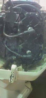

Ok. I added pics hopefully they post!
Mod. No. J90TSLEVA
Ser. No. G 04302527
CE 02/199
Power 65.6 kw
Mass 137 kg
Top left is - orange/purple
Bottom left - orange/pinkish
NOTE: These are the crossed plug wires. Top to bottom, bottom to top
Top Right- orange/blue
Bottom right- orange green

Switch those wires as a test.----Normally top coil goes to top cylinder.------And no you can not do any damage if it is correct now !!

The motor left the factory with a number of clips holding plug wires in place.----Normally the top plug wire goes to the top coil.----It does on all those V-4's that I have.
