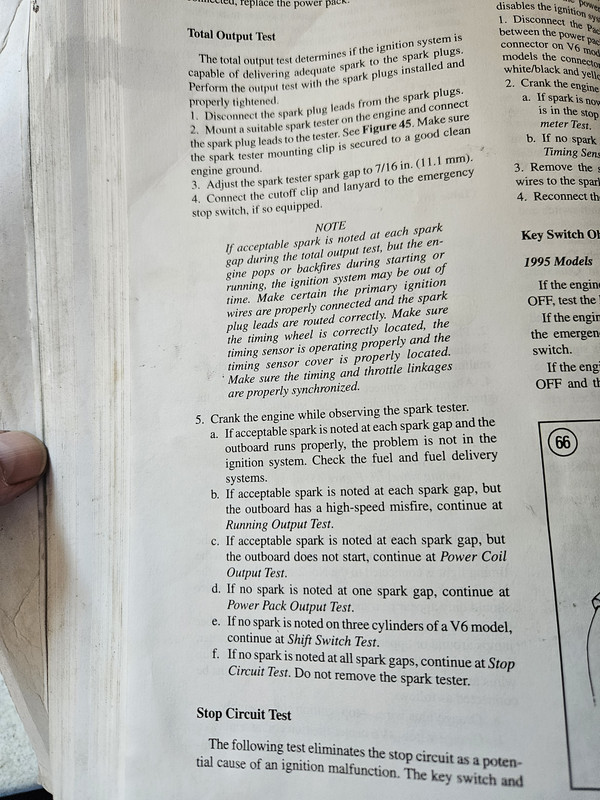

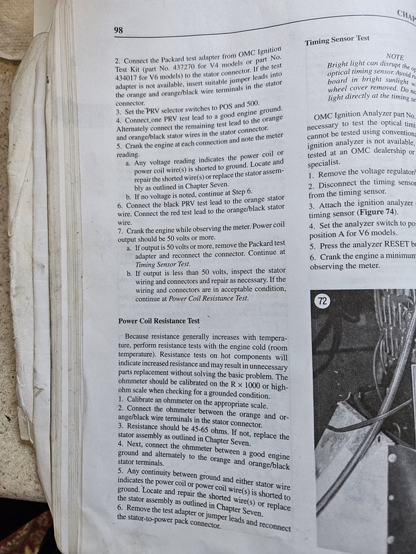

I did the voltage supply test as per the attached instructions, check voltage to the J terminal in the power distribution panel while the engine is cranking. The good book says I should be getting 9.5 volts or higher, mine tops out at 9 volts. When it is not cranking I get 12.5 volts. I have a brand new battery, same model that was in there, the cables, battery switch and ignition switch are only 6-7 years old. I moved on to the starting system components, the Total Output test (spark noted at each plug but engine will not start) directed me to Power Coil output test, I make it to #7 in this test and I don't get any voltage and I should be getting 50 volts or better. I moved on to the Power Coil Resistance test and I'm not showing any resistance between orange and orange/black. It's suggesting I replace the stator assembly. My question on this resistance test is should the key be on? Cranking? Or in the off position? I'm assuming off the position.

The written instructions are WRONG. You can never get more than battery voltage in a ...NORMAL... battery system with the key in the off position.
Your new battery is LOW. Connect a RELIABLE battery charge to it for several hours. It needs to be charged up to at least 13.5 volts to...FULLY... ACTIVATE all of the battery Lead inside of it. Right now your battery is completely run down. It is useless to start the engine reliably.

Throw that Selco book away as its wrong. Those tests are for a carb motor!!! Also your stator is a 3 phase stator and does not have a org/org-blk wire. So are you sure its a FICHT? The only org and blk wire coming from flywheel cover is the CPS

Thank you for chiming in faztbullet & Cyclops, my book is a Clymer (not that its any better), and it has a supplemental section for the Ficht, and yes I went down the wrong path. Back in the Ficht supplemental section I started the process of elimination, it appears that my coil pack round straps were not grounding properly, I cleaned them up and and the engine started right up. I took her for a sea trial, she runs great at idle, but when I throttled her up she ran good for a while and then bogged down and died. After 2-3 minutes of sitting she will start up again, it did the same thing a few times then I idled back to dock.
