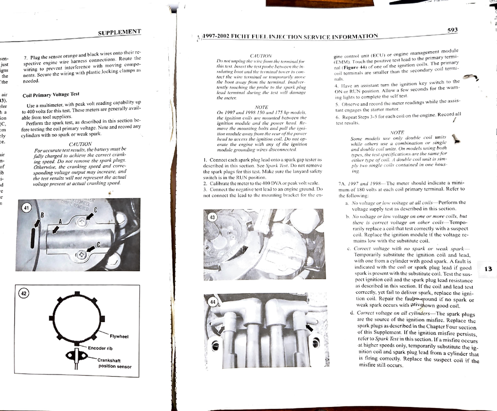

Test output to ignition module from ECU
In conducting voltage supply tests, I placed the positive meter lead on the fuse for the "Ignition System", with the key on the voltage should be 1 volt less than the reading at the battery, and it is. While cranking, this voltage should be increase, but it doesn't
I attempted to test the voltage coming to the coil packs, the instruction said leave the primary coil wire connected, insert a test connecter (sewing pin for me) into the boot of the primary coil wire at the coil, with the meter, red to the test connecter, and black to engine block ground. When I crank the engine, I should get a minimum of 180 volts, my meter reading says -8.5 volts. I tried it on several primary coil connecters and I get the same result. I am either conducting this test wrong, or it's pointing to the problem. I think it's also important to note that it is/was an intermittent problem. Any thoughts?

the 2002 -2006 FICHT _ETEC book doesn't mention much on the 180v your refer to ...unfortunately I have no access to a 20011 manual but if you found that info in a reliable book you may be on to something.
